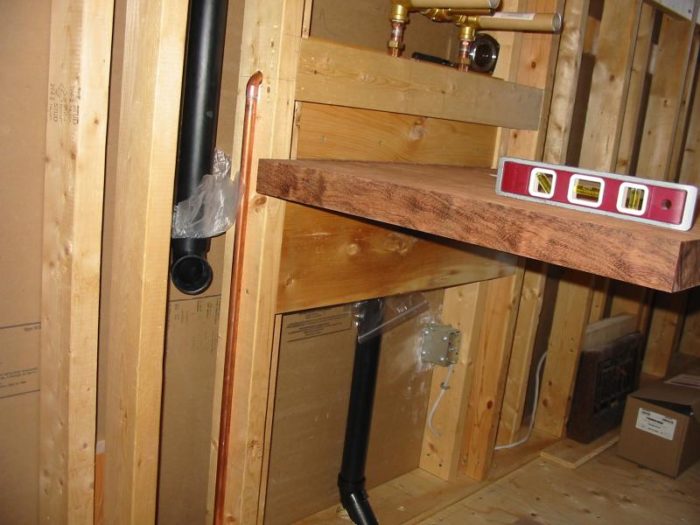

Question,
.. I was thinking about cantilevering a bathroom counter by bolting 2 steel rods to the side of 2 X 6 studs and drilling corresponding holes for the rods in a slab of wood.  The idea is to provide wheel chair access.  Anyone done this before, or can calc how thick the rods would have to be to keep it from sagging?  With only 5″ in the wall would it support a 21 inch wide counter top??  I’m thinking flat stock would be stronger than rods (?) but didn’t want to cut slots in the bottom of the slab .. opinions (and engineers) welcome .. thanks in advance.

  7. wane | Apr 20, 2009 07:45pm | #11
    so here's what I came up with, rather than trying to drill holes and support with steel pipe, I just ran a 2 x 8 (some nice dry salvaged stuff, no more shrinkage) horizontally across the back of the wall, another across the front.  The front supports from underneath, the back across the top.  I left some room in case it ever sags, I can add a shim across the back to re-level it.  I wouldn't sit on it, but it'll take just about anything else, very firm.
      PeteDraganic | Apr 21, 2009 05:31am | #12
      glue those blocks in place too... while you can get to them.
