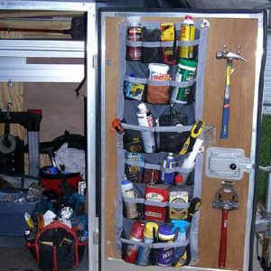

    REAR DOORS
    1. hanging storage on doors
    2. less required space behind trailer
    3.ease of opening and closing.
