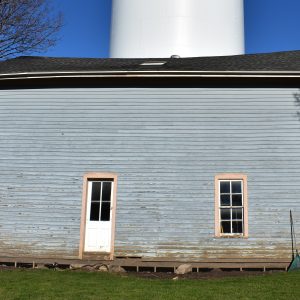

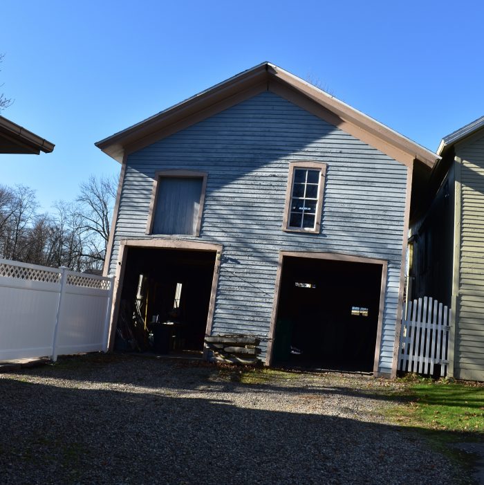

Looking for some suggestions on options to save my 1880s carriage house 25’x30′ located in Upstate NY. The structure is leaning left to right and touching the neighbors structure. Front to back is fairly level. The lean developed from a hole in the rear right of the roof along with both roofs dumping water down onto the right side foundation beam.
The carriage house “sits” on piers with beams around the perimeter. The structure is balloon framed. Wood floor.
The carriage house has a new roof and sheathing however some of the rafters have developed cracks, previous owner installed 2×6 rafter ties.
Lots of temporary fixes have been applied from previous homeowners.
I am looking in the process of searching for permanent fixes…please let me know what you thoughts are on saving this structure.

    It looks like, among other things, the roof load has pushed out the top of the wall plate in the center. You have some serious issues, and this is a case where it's probably worth getting a structural engineer out to look at it.

    Come alongs between the two walls to pull them back together. Hydraulic jacks to jack up the sidewalls. New foundations to support the load. This might be a fairly big job or not. Tough to tell from the photo's. The structural engineer is a good call as they are licensed so you should at minimum get decent advice, however a good builder or carpenter would be able to do just as well. The problem is knowing if your builder is good or not?
    If you are confident and capable it could be DIY but you need to know your way around structure.
