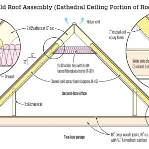

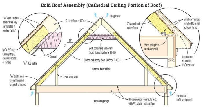

I’m considering doing something similar to the attached pic.  A “vent chute” seems to be the way to go but we are not sold on the spray foam.  We are thinking make the chute as in the attached pic and then use R-38C to fill the remaining space.  I have concerns though…  Im not sure I completely understand the vapor control aspects.  Should we use faced or unfaced.  I’ve read that some are using the MemBrain product in these areas.  Should we just scrap the fiberglass and go foam?
