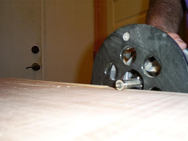

You use a lam trimmer with a FT bit and climb cut to finish the piece.  I’ll post some pics, and if anybody wants more explaination, I’ll post a more complete description.  It’s really easy once you do a few.

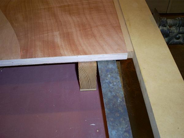

    Cauls work really well. I will make some. You are right about that iron on junk. I have been doing solidwood edges for over 20 years. No call backs. I want to see more of you method and thought I would share mine.

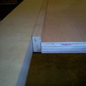

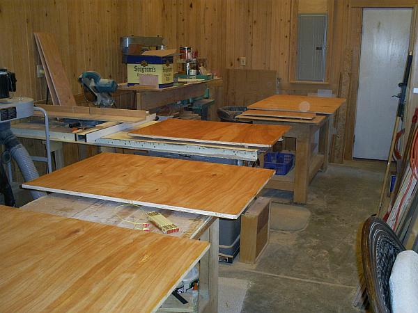

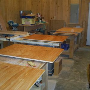

    I use 3-1/2" rips of 1-1/8" MDF that are not cauls.These are 1/2" solid wood edges. I oversize my panels so I get 2 sides, tops, bottoms, stretchers and shelves from each glue-up. Oversizing eliminates end trimming.

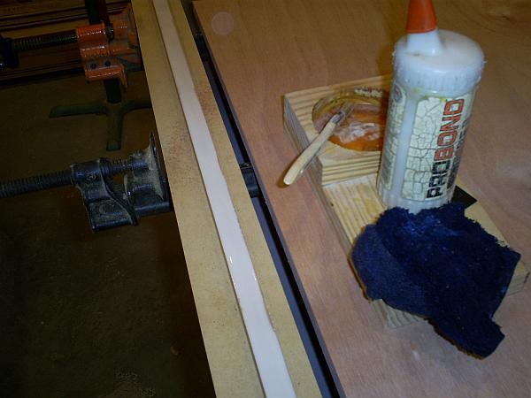

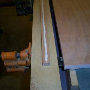

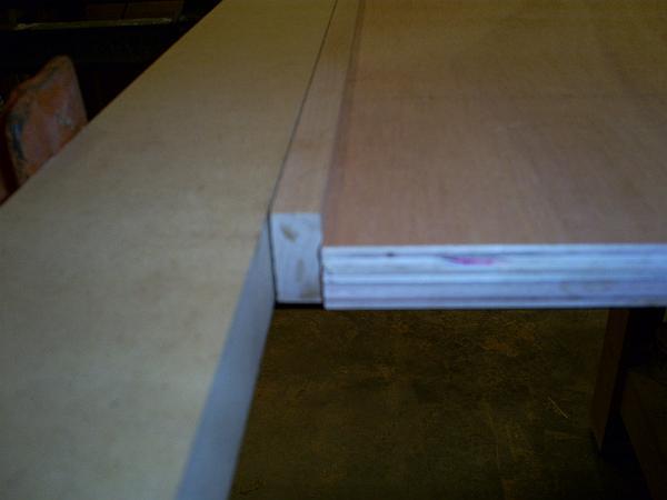

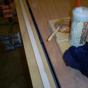

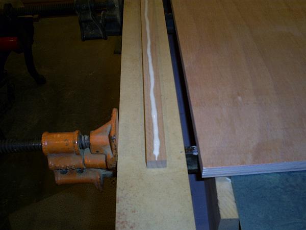

    I run a bead of TB III.
    Then brush it for full coverage.

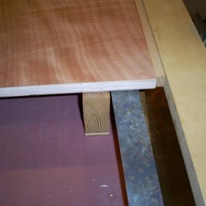

    Clamp it using the MDF rips.
    A 1-1/4" piece is glued for the wall scribes.

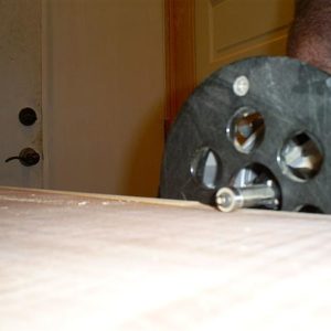

    The edges are flush routed.

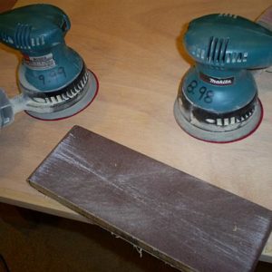

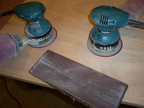

    The edges are sanded with 80 then 120 and get eased.
    A coat of sanding sealer is next.
    The panels are sanded with 150, double cross cut to length then ripped to size. Sometimes the dados are cut before ripping.

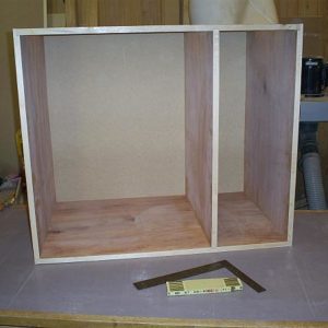

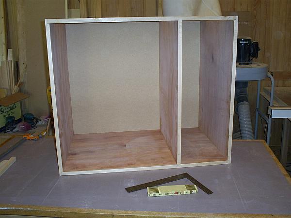

    The units are assembled in the usual manner.

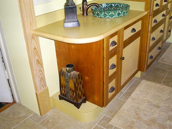

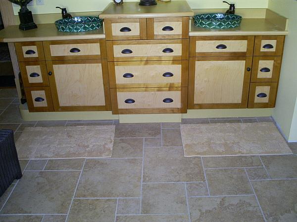

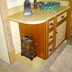

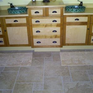

    The finished units.
