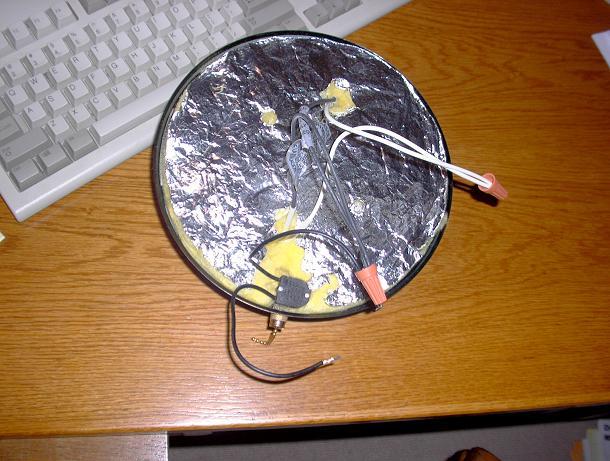

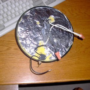

  4. JMadson | Jun 16, 2006 07:59pm | #11
    Here's my proposed solution...
    I went out and bought a standard ceiling fixture from the big box. I also bought a replacement pull cord switch found in the ceiling fan parts aisle. Drilled a hole and added the pull cord.
    Anyone see any potential issues with this?

    1. Stuart | Jun 16, 2006 08:13pm | #12
      Are pull strings permitted in bedrooms where you live?  I'm not an expert on residential electrical stuff and it certainly varies from one part of the country to the next, but here in Minneapolis I believe bedroom lights are required to have a wall switch.

      1. JMadson | Jun 16, 2006 08:38pm | #13
        Thanks for the response.
        Prior to being a light, it was a ceiling fan w/ a light, both were controlled by pull cords. This is the same for all three bedrooms in our house. I believe the unswitched ceiling fan is very common around my area.
        I'm more looking on feedback from a fire prevention standpoint.  “The significant problems we face cannot be solved at the same level of thinking we were at when we created them.” – Albert Einstein

          4. FrankDuVal | Jun 17, 2006 07:08am | #23
            From the picture you posted, I see no problem with your approach or wiring. Years ago this was a common way to switch bathroom lights.
            You probably have a wall switch that controls a receptacle with a lamp plugged in. That would satisfy the wall switch requirement in the IRC. This requirement does not mean ALL ceiling lights have to be wall switch controlled. Cloth twine or metal chain is OK.Frank DuVal You can never make something foolproof because fools are so ingenious.
            maddog3 | Jun 17, 2006 04:04pm | #24
            the fixture is fine......the switch is fine......... the whole setup is OK do not use larger lamps than the fixture is rated for........thats allI don't see a fire hazard .......just keep all the wiring above the insulation in the canopy......Do you want me to come over there and wire it for you ....? I don't have a problem with that either ......for free even !!!.
