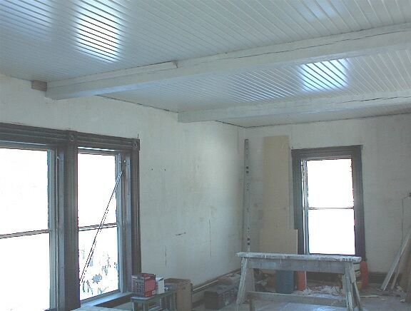

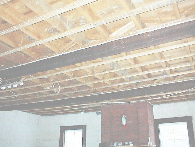

For such a large degree of sag, you might need two bt's but we normally furr it straight with 1x4 or in New England, you can buy "strapping" 3/4" x 2-5/8" Use cedar shims or other block wood to get it level from the bottom of the joists. The attachment shows furring in the living room of my job. You can see where I needed to shim it down a little in the back corner. The second attachment is as of today with the finished board in place, moldings tomorrow.
