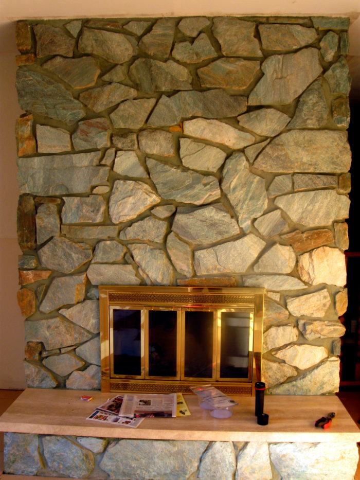

  3. overthetrail | Apr 18, 2011 02:07pm | #5
    Results?
    Hi Tabatha ~
    I've been looking for someone who has the same issue with covering up ugly stone as we do.  I wondered if this technique worked for you or if you have any suggestions for things you figured out along the way.  We have a stone fireplace that is turquoise and have been puzzling over a way to change it.  We had decided that cementing over it and putting a skim coat over the top would work, but like you we have stones that jut out farther than others and it's a very uneven surface to cover over.
    Thanks!
    Sandy
    p.s. I've attached a photo.  It is MUCH more blue/green than it shows here.
