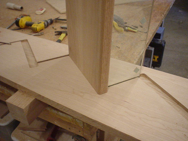

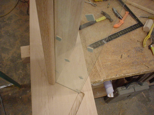

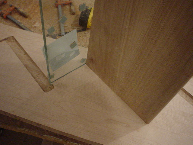

I am building two staight stairs stacked on top of each other that will have cherry treads with 1/2 inch tempered glass risers.
The tread in the picture is a leftover oak tread. Leftover in that the contractor incorrectly told me and signed a contract for this stairway to be in oak. EEEEKKKKKKKK!!!!!! $7800.00 mistake. So…I have the stringers done again…..and am working on the cherry treads.

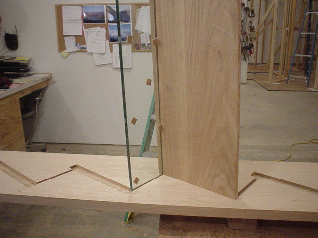

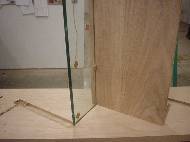

Do you allow for movement in the tread, making the riser loose or floating? Or do you make everything tight as your routs suggest?
I can just see my toady arse stomping up the middle making the the treads groan and the risers crack.
jag: The treads are a full 1.5 inches thick....and only span 36 inches. The risers are temered and I really believe the treads would split busting the risers. However....the dadoes for the risers have just a "little" slack. The risers will have clear silocone at the top of the glass into the tread....and rubber glazing blocks in the rabbet at the back of the tread. This should allow for some movement. The back of the treads rabbetted glass will have a tread cut off that will be trim screwed to the rabbet so that the riser could be replaced and also put in.
I have the mortise on one side one inch deep. The riser will go into this deep mortise enough to get inside the stringer on the opposite side...then the riser will go into a 1/2 deep mortise on that side. When its all done....should have 3/8 inch of glass riser inserted into the rabbets on both sides when centered.
