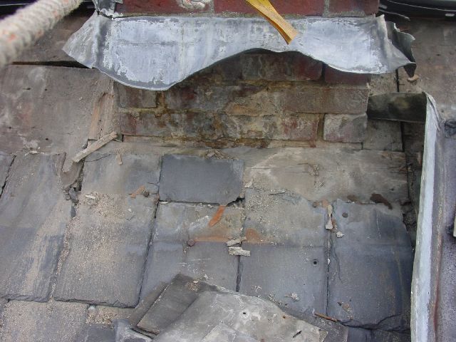

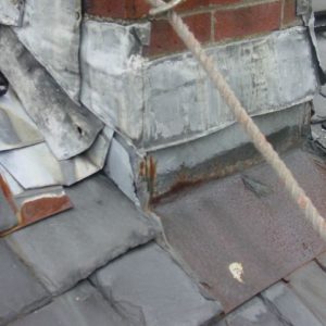

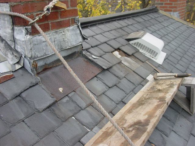

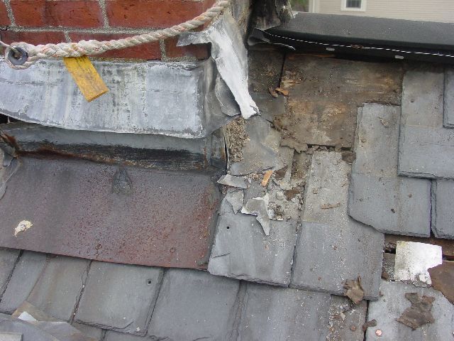

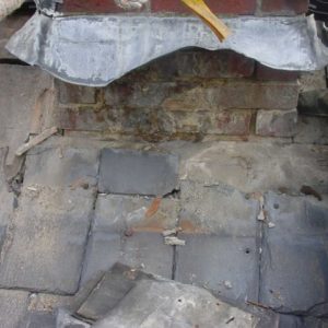

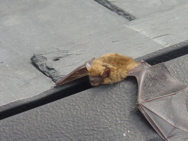

Was hired to reflash this brick chimney-  started today Oct 31

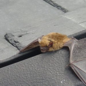

Guess what appeared while removing the slate and flashings?
Picture 59 shows my scary helper.

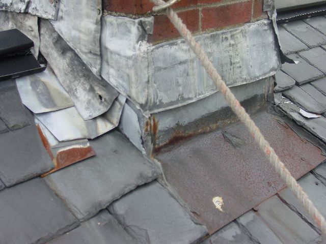

Notice the many different metals on this old flashing job   lead,galv iron,zinc,and alum ridge vent.
I’ll be using Revere Freedom Grey copper for my roof flashings-then lead for the counterflashings.
  1. Piffin | Oct 31, 2006 11:16pm | #1
    Would be a good chance to upcharge a change order and do some pointing up while that is open.
    I have lost count of how many bats I have seen under ridge and chimney flashings. They usually hunker down or fly off tho. Good picture.
    You forgot to list Ferrous Oxide amoung the many metals on that chimney, LOL

      i've seen quite a few too-but not while toting a camera on Halloween!
      1. davidmeiland | Nov 01, 2006 12:03am | #3
        That's a great looking bat, and I like the nasty scowl he's giving you. Just tell me you let him get outta there instead of dispatching him. We got one in the house thru a hole I had cut into the attic, while we were reroofing. He appeared in the living room one evening flying around very slowly and silently. My wife screamed bloody murder. I turned on the porch light and opened the front door, and turned off all the other lights. Eventually he left, but he did about 50 laps around the house first.

          Bats are extremely voratious on our native insects so they are worth having around-just a little scary when you open up flashing and you see them looking back at you.

        I am curious though, have any of the bats you've disturbed been nasty towards you? I've got old closed chimneys in the VA house and I am nearly positive there are several in there. Last summer a guy was painting the roof (metal) and at dusk there were a bunch around the chimney.
        Wondering what the proper protocol is. Not looking to kill them, but if they get to be a PITA...

          They are usually groggy when woken up like this during the day. He keep chattering at first then crawled into the crevice on the ridge cap opposite to where I was working.
          He remained there until 3   from 10 that morning    until  I prodded him to move again.  He then flew across the road into a big pine tree.
          I've never had one dive bomb or attack me but it may happen.
          Thanks   Walter

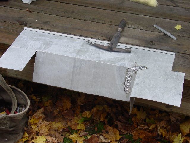

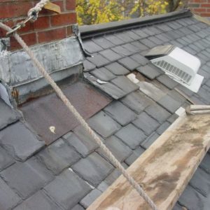

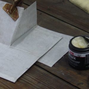

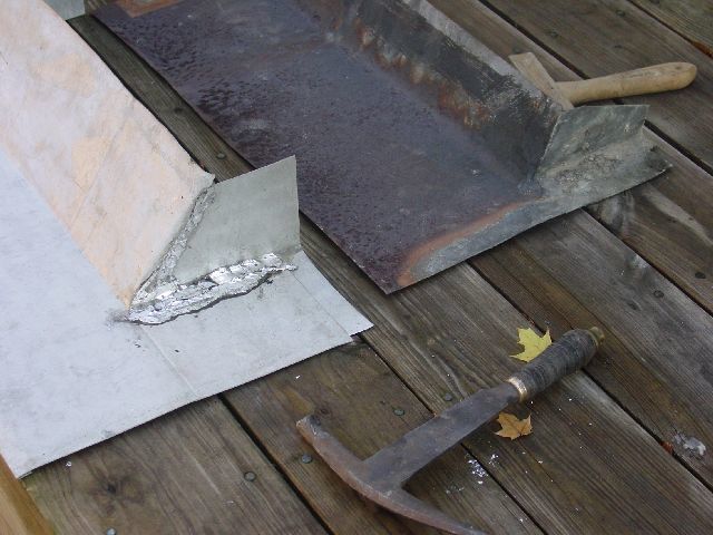

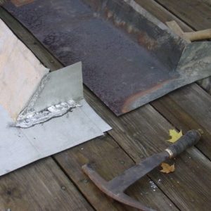

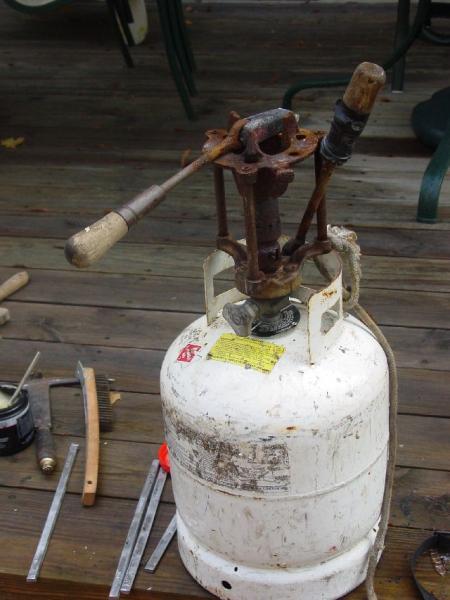

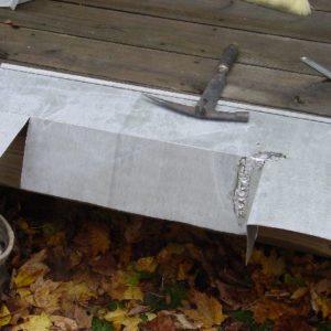

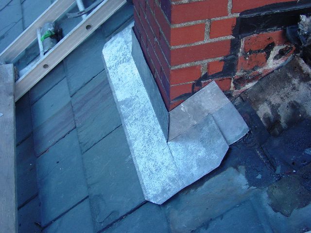

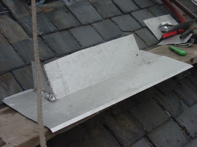

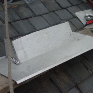

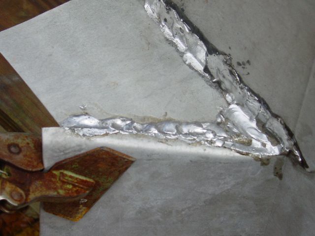

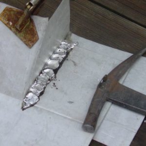

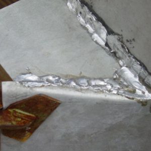

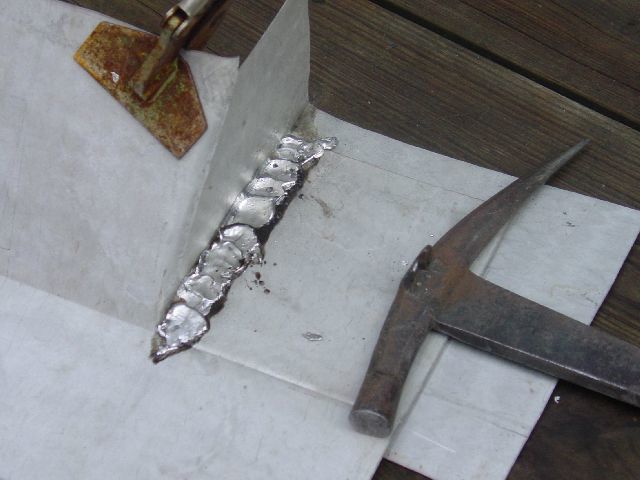

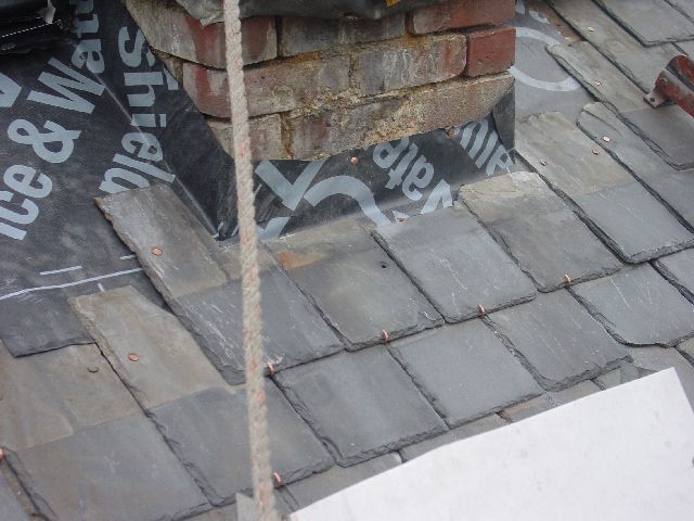

      I'm putting on some more today of making the "pans" for the base of the chimney-it's on the ridge so it has two bottom pans and no upper.
      The chimney needs to be rebuilt next Spring so I'm only flashing the roof for now-the lead counterflashings will be redone when the new brickwork is laid up.My mason won't have time before freeze up to get to the topping.

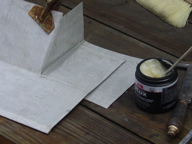

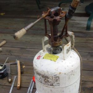

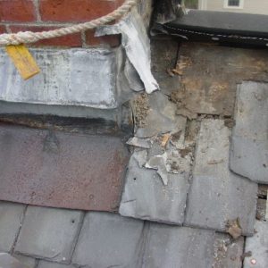

      These pictures illustrate making up and soldering the pans,both front and back sides. One also shows the old galv. pan that I'm replacing

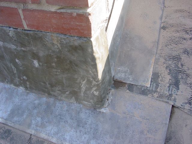

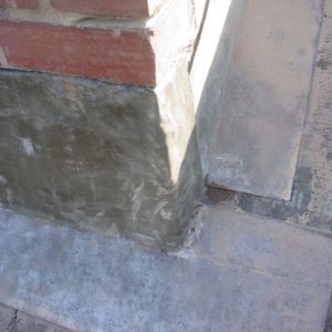

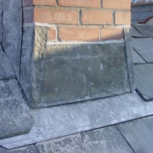

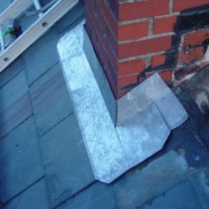

    2. theslateman | Nov 12, 2006 12:07am | #19

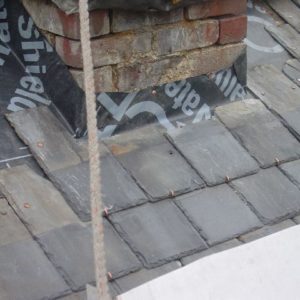

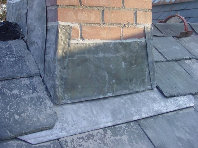

      This is a different chimney,but it shows the lead counter flashings coming down over the lead coated copper pan and step flashings.
      Hope you're still interested in the finished shots.

      1. Bentstick | Nov 12, 2006 12:15am | #20
        Looks nice. It looks like your new counters cover up all of the nice black stuff which was on the brick.
        Are lead flashings around a chimney traditional? I noticed in another thread, half of a copper valley was being replaced. Why would they not use copper for chimney flashing?
        Nice work.
        If it wasn’t for the Bank Payments,
        Interest, Taxes, Wages, and Fuel Costs,
        I wouldn’t have to charge you!!
        1. theslateman | Nov 12, 2006 12:22am | #21
          The roof flashings are lead coated copper on this last chimney flashing,but traditionally sheet lead is used as counterflashing in our area.
          It's more malleable to form in the reglets that are ground out and to turn the front corners-but you could use copper for both the roof and counter flashings if thats what the customer wanted.
