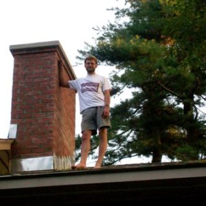

I know I always appreciate it when people come back to old posts, and show us how a project turned out in the end.
Well, 5 years after asking for advice on it (see original thread 21017.1 if you like)
…I finally rebuilt my chimney from the roof  up.
Took me a week working solo.  Satisfying work, but I certainly won’t miss hauling brick and mortar up a ladder.  It’s nothing fancy, just functional.  I had intentions of doing something more decorative with the brick instead of just the single corbled course at the top; but time was running out and I had to just get it done.
I hadn’t counted on the new modular brick being smaller than the oiginal, so my head joints are a bit larger than I would’ve liked.  Otherwise, not a bad first-time DIY brick project.
Many thanks to MikeSmith and others for their initial advice.
Mike: I also used your trick from the “Adverse Conditions” thread with the rope wrapped around the clay liners to isolate it from the poured cap.  Worked like a charm!
My stainless flue cap is on order, then I can scratch this off the to-do list.  Now the roof is next!

    Nice work. You saved yourself some jack that's for sure.
    1. Stray | Sep 27, 2007 10:11pm | #2
      True enough.
      If course now I know why the price I originally got ($4-$5K) was as high as it was!  I think my arms stretched an inch longer carrying bricks up the ladder...

            Stray, nice work!
            You say you'll be re-roofing next?  How will that effect your existing flashing? (Done beautifully, BTW).

            I did new counter flashing, but left the old step flashing in place for now.  It doesn't show well in the photos, but the roof is realllllly bad, and the step flashing was glopped with multiple layers of roof tar over the years, making it "one" with the FG shingles.  I was afraid if I tried to remove the steps, I'd be into major shingle repair.  The roof just has to last until spring.  I think I can do the new steps by carefully removing the old and then sliding the new ones up behind the counterflash as I go.  We'll see if that works out or not

            "I think I can do the new steps by carefully removing the old and then sliding the new ones up behind the counterflash as I go."
            That should work.

    And you did all that in your bare feet!?!?
    1. Stray | Sep 28, 2007 05:33am | #8
      re. bare feet
      Actually, I had expected to get some form of safety reprimand from some BT'er for that photo!
      if I had boots, maybe it wouldn't have taken me the whole week LOL!
