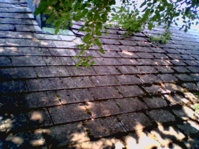

I understand the best choice would be to use a lift. But that would require removing an vine covered arbor and cutting down a bush or two.
So how fragile are the asbestos shingles generally??
I envision a scaffold setting on plywood with cushioning under it!
But I don’t know.
Thoughts please.

That type of asbestos shingle can be treated as slate for removal and re laying .
If you have a slater's ripper you could remove some in strategic places to enable you to set stagings and then put them back in with slate hooks after you're finished.
Do you have a set of chimney bracket scaffolds? That would make the set up real solid and easy to work from.
You could pad them and do as you suggest too,but it will be more secure and safer if you nail thru where you have removed tiles.
Slateman,Really? Remove and replace the shingles?! That never occured to me!I don't have a ripper. And I'm not sure I want to try that. I'll have to think that over.If I do not use a lift, I was going to be securing the "scaffolding" by hooking over the ridge. The padding would only be to protect the shingles.Thanks.Rich BeckmanAnother day, another tool.

Try using a couple of hook ladders---one on each side of the chimney.. If you need to----additionally you can use some ladder jacks on the hook ladders and run a plank in between.

Stephen's idea is a good one .I've topped out chimneys off ladders and brackets over the ridge,but it's tight to the chimney that way.Vanguard makes a chimney scaffold with an adjustable set of supports to make the top platform level.
It also will accept lifts of pipe staging since it's the same 5'x7' dimension as standard frames.That way you can have a nice wide platform to work from.
A lot of masons in my area have me set staging for them when it's a "hard" roof,meaning slate,tile or asbestos.Maybe you've got someone nearby to do the same for you.

the ones I have been on---the tiles are quite durable and flat. there was a little flex to 'em---not like that asbestos tile siding which is brittle as hell.
I am assuming that chimney is close to the ridge---so it's not high above the roof line?????.
I would do it from 2 hook ladders-----maybe not even the plank between'em.
One warning though---- those lichens and moss and stuff growing on 'em??????
slippery as effen hell!!!!!---unbelievably slippery when damp even from dew---so watch out.
I haven't broke any yet------but If I did, I have a yard 40 minutes away that sells reclaimed slate, tile etc. that I could get a reasonable repair piece from.
that availability seems to gauranty that I don't break any----if they really were irreplaceable---then I would be sure to break a few!!! LOL
BTW---you aren't being suckered into this by a little old lady with no money are you???
Stephen
My butt has never hit bottom so fast as when I stepped on damp moss on an asbestos roof!
The moss issue brings up a good point of interest.Yes the roof becomes very slippery when damp moss is on it,but the real concern is that moss indicates the softening of the cement so that it can act as a host for the moss to grow.With that overhanging tree the roof stays more shaded and damp and the tiles after 75 years or more become softer and will then develop moss on them.This is a signal that the roof is nearing the end of it's useful life.

My experience (limited) is that they are more brittle than slate. (there were several different thicknesses, from what I have seen, and the thinner ones would almost certainly be more brittle than the thicker.)
I'd be cautious about using a ripper and removing them, unless you know some old roofers who have a stash they use for repairs.
It would be possible for an experienced hand like the Slateman to rem,ove and save for re-installation
But
In the photo, I see a couple with broken corners already and I bel;ieve I see one at the upper chimney corner well beedded to the criket flashing with caulk, suggesting previous repairs. I would figure on losing a third of these to breakage if I were removing them, based on previous experiences with asbestos shingles. On easy good ones you can lose 5-10% anyway So find a source for replacements first.
But then you might end up looking for replacements even if you do the scaffold over it deal with cushions.

If you think replacements are in order than find some first as others have suggested.
A source to look for them might be http://www.jenkinsslate.com
They have several names of recycled asbestos shingle salvagers-although I bet there are roofers locally that would have some that match whats on this roof.That can't be the only house with those shingles in your town.
Lots of times there are extras stored in the cellar or attic of the home itself since most good roofers would leave spares for future replacement on a roof expected to last for 80 to 100 years.
