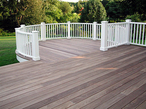

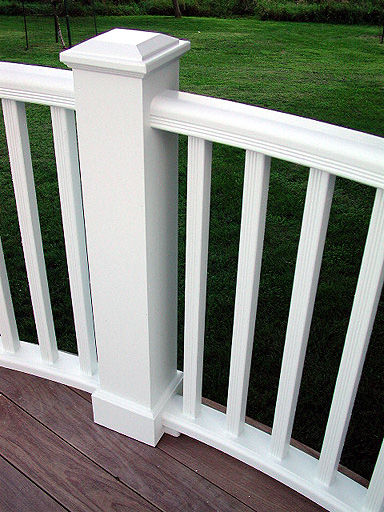

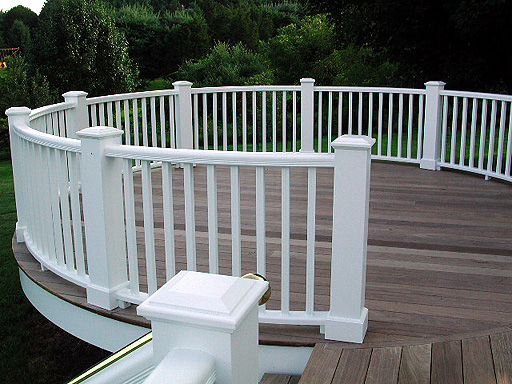

Just an update on that deck with a circular tier I was building (see message 43975).  Here are some pics of the circular railing and posts I made.  It all went pretty well.  I only have the latticework on the base of the deck to complete.  All in all, there was certainly extra work involved, but I think the end result was worth it.

    1. jpainter | Aug 10, 2004 05:04pm | #10
      Diesel & Others:
      Well, the secret to the rail was not bending at all. I've done some of that, but it wasn't practical for this application.  The rails and balusters are clear cedar, which makes one think twice before making each cut!  The bottom rail is 2x10 cedar which was cut to the shape of the curve. The top rail is a sandwich of 1x10 and 2x10 cedar to get to the thickness I wanted.  They are glued with poly glue and tacked together with brads.
      The curved shape was accomplished with a process that started with a luan plywood pattern.  The curved pattern was screwed to a 2x10 blank and then I cut within a 32nd to the line with a jigsaw (gotta love the accuracy of my Bosch).  Then I took the pattern/blank to the router table and used a 2" straight pattern-cutting bit to clean up the line right to the pattern.
      Now, after creating all the curved top rail blanks, I milled the top curve, the middle bead, the bottom chamfer and the groove underneath that received the ballusters.  Of course, since these were curved, I needed to create two curved FENCES for the router table (one inside, one outside) in order to use the router.  It sounds crazy, but I did all of the curved pieces in one day in production mode.
      The posts, by the way, are made entirely of Koma, with a 4x4 pt post inside.  The decking is ipe.  This is my own deck (I'm just a local-yocal hack) so I could afford to go a little over the top.  The more people told me it couldn't be done the more stubborn I got! I'm funny that way, as are most of you, I'm sure. :-)
