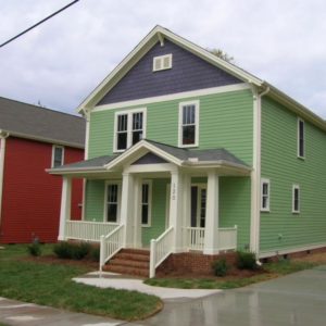

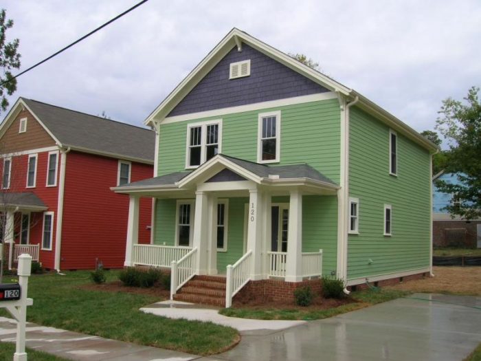

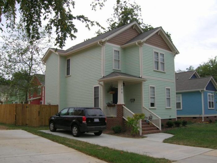

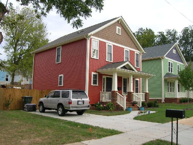

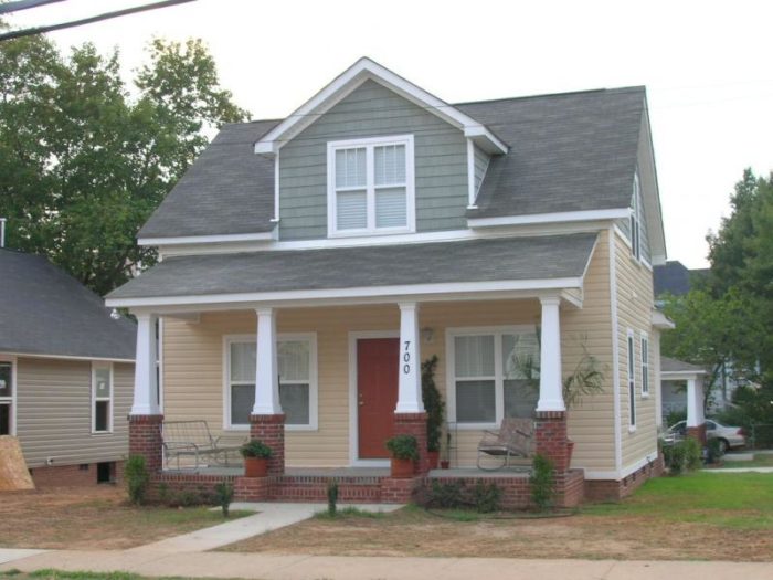

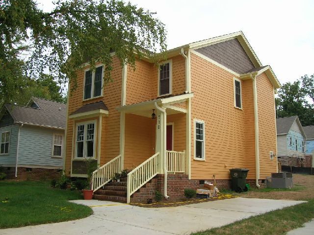

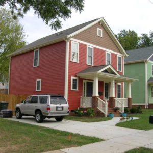

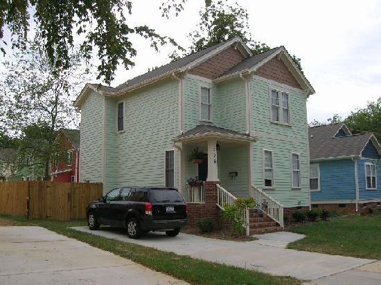

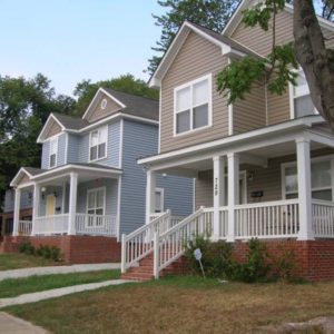

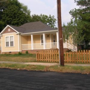

Here are some pics of some houses I’ve reciently completed in a city neighborhood.  This is downtown Raleigh NC.  The locals call the area “Oakhood”, since it’s right between Oakwood and the hood.  Oakwood is a historic yuppie neighborhood.  The hood is, well… the hood – but seemingly not as bad as you might think.  Anyway, Oakhood is not your average beige vinyl suburb…  Square footages are between 1500 – 1700.  I’m doing one now that is 2100.
BTW – just got a new camera – hope the pics aren’t too big for screen viewing.
  1. Shep | Sep 15, 2005 04:46am | #1
    WOW- ya got some bright colors there.
    (got my sunglasses on now)
    nice looking homes there. Not just some cookie cutter boxes. If you don't mind my asking, what does something like that go for.
    Been awhile since I've been down that way. I've got friends that live in Hillsborough.
  2. Hooker | Sep 15, 2005 08:05am | #2
    Very nice houses.  I actually like the use of colors.  Are these presold homes or specs on a lot?  Who determines the plans and colors. etc.?
    Wouldn't mind seeing some interior pics if possible!

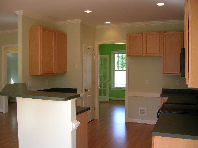

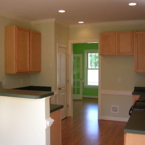

      Here are a few interior pics of the house that closed yesterday.  This house was ~180k and was a presale.  The HO had me delete out the fireplace, which I think is a major design element and focal point of the family room and the way we did the marble surrounds and mantle looked pretty good on the other houses.  I think they were worried because they have small kids.

        Those are some nice, clean interiors.  I like the wide casings and the use of different colors in different rooms.  It kills me when I see $500,000 houses here in NJ with 2 1/4" colonial casing and everything painted Builder's White.

          You beat me to it! McMansions in Northern NJ don't come close the details on these houses....that's not a mistake, it's rustic

        Very nice inside and out. I think you've met your goal of building beautiful homes that normal people want to live in.
        Thanks for sharing the pics!

        I'm very impressed with those interiors. As someone who does a lot of trim, I really like the detail you put into the inside of that house.
        As others have already said, 2-1/2" colonial casing doen't really cut it.
        I hope the new owners appreciate it, too.

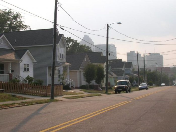

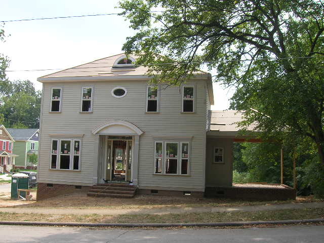

      Matt | Sep 15, 2005 01:23pm | #4
      Builder & the other above posters:
      Land is hard to find around Raleigh, however these lots are part of a City of Raleigh Community redevelopment project, so the lots are sold to us at a significant discount (maybe 1/2 or 1/3rd actual value) but then the city gets to boss us around as to what we build.  They want homes that are "historically appropriate", and they have to OK house plans, exterior details and exterior paint colors.  They had some house plans, but I think my boss-man trashed them thinking that the interiors were not conducive to modern lifestyles (and buyers's tastes).  He builds up to $2mil spec homes (elsewhere) so I have no doubt that he knows exactly what he is doing... There are 4 builders involved in this particular project and there are about 30 lots.  I have a good repour (sp?) with the city people and his archies and I think we generally all have the same vision, so it all works out good.  70% of the homes must be affordable by county residents with mean income and there are some finance programs available for these homes.
      Re the exterior colors, they were mostly picked by the homeowners.  They were mostly spec houses but all sold by the time drywall was in.  One was a presale.  I actually picked the colors on one house - the one that is probably the most controversial... It came out a little brighter than I thought it would ;-)   We had a designer but she was big on lt grey and beige :-(, so her exterior selections were not used (I don't think she shared "the vision").  The historic Oakwood neighborhood is right next door and there are a number of brightly colored houses over there too, so it all fits.

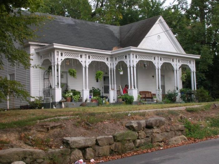

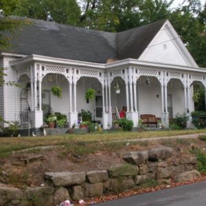

      Re the Oakwood neighborhood, there are some fantastic examples of late 19th century architecture over there.  Victorian, craftsman, shingle to name a few.  These houses range from very modest 'shotguns' to homes built for the wealthy.  About 2 blocks up the street are 3 fantastic Second Empire Victorian houses, obviously all built by the same builder, one of which is pictured in a book I have A Field Guide to American Houses.  The Governer's mansion is 6 blocks up the street.

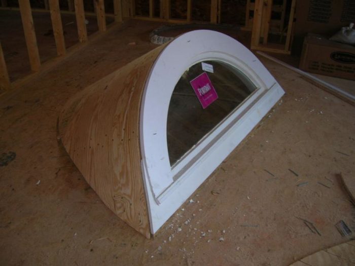

      The houses I built there were priced between 150 to 185k.  The 2100 sq foot house that is underway is not going to be so "affordable" as it has (will have) high ceilings (10' 1st, 9' 2nd) , granite, and quite a bit of trim, along with a bunch of other upgrades.  If any of you caught my thread about antique style push button switches, it was for this house.
      Re interior pics - my camera has been broken for several months, so I don't have any.  Maybe can take a few today of the one that is closing, but the interiors are fairly modest on the houses I posted pics of.  A little crown here and there, and just a few other upgrades.  You really can't get too fancy in that price range.  Maybe I'll get some on this larger house as it progresses.

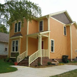

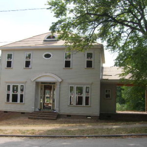

      Attached is a pic of that house.  It will have an eyebrow type dormer - sort of - and a big arch over the entry way so it will look better soon as the siding is on which is what we are currently working on.

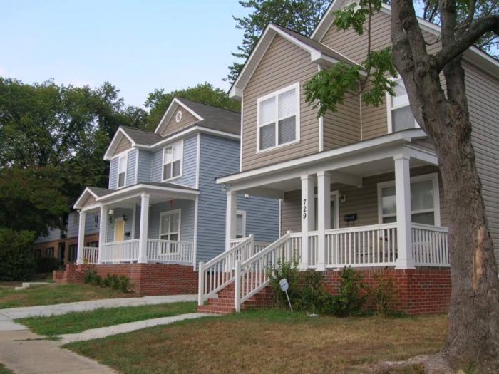

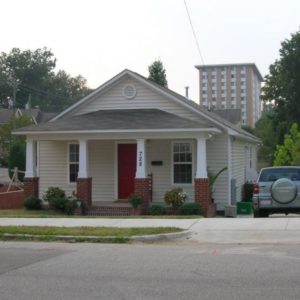

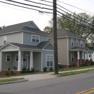

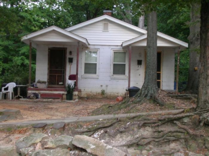

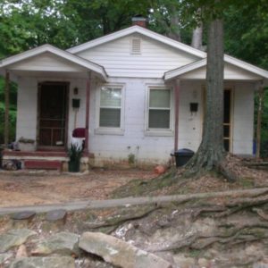

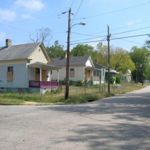

      Attached are also a few nieghborhood pics to give you all more of an overall view.
      Edited 9/15/2005 6:33 am ET by Matt
      1. Lansdown | Sep 15, 2005 04:36pm | #5
        Nice colors - reminds me of the painted ladies of San Fran. What kind of siding is that?

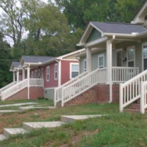

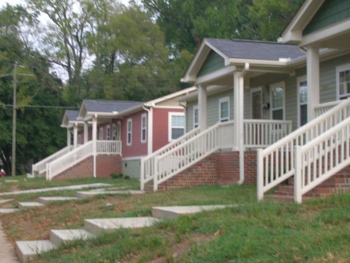

        Here are some more "city houses" that I finished up last month...  These are considered affordable housing.  There was a cap on the sales price as set by the city and further we were required to sell to first time homebuyers.  Little different than your average subdivision houses and McMansions.
        These are the Energy Star homes I spoke about in another thread recently.  They range in size from 1336 to 1525 sq ft so they are modest homes.
        Edited 1/3/2009 8:46 pm ET by Matt

          3. pghdan | Jan 04, 2009 06:15pm | #72
            I love the look of these houses.  Part of what I like is the fact they sit out of the ground and have nicely detailed steps up to the front porch.
            I know you stated these houses weren't directly subsidized....but were any issues of accessibility brought up by the city.  I imagine if they had been directly subsidized then accessibility would have been an issue.
            Dan
            Matt | Jan 04, 2009 06:39pm | #73
            Thanks for your comments.
            >> Part of what I like is the fact they sit out of the ground and have nicely detailed steps up to the front porch.  <<
            I brought dirt in on 3 of the houses.  Two were a little low and on the third the dirt was right there on the next lot over and free.  The brick steps were part of what the city wanted, although it is not really an appropriate historic look in that area.  I had the bricklayers do the revels on the steps and some other little details.  Also, my concrete guy will add in some extra finishing for little or no extra cost if I just tell him what I want.
            >> I know you stated these houses weren't directly subsidized....but were any issues of accessibility brought up by the city.  I imagine if they had been directly subsidized then accessibility would have been an issue. <<
            Accessibility was not discussed.  Thank gosh - many people like to say these kind of things like that but the fact that it costs real money alludes them.  They think that something like this is a $5 expense that the builder should just include for the same price.  Also, 2 story and acceptability don't go together very well.  The city also wanted crawl space homes - if they were to be accessible, slab homes would be more appropiate.

  4. timkline | Sep 15, 2005 04:53pm | #6
    I wish our local builders would do more like what you've done.
    Really nice.
    I have only two thoughts/complaints which involve design.
    Why don't the first floor window heads align with the exterior door heads ?
    Why doesn't the window layout of any tract-type built home have any semblence of symmetry  ?   These houses are lovely but could be much more so if some consideration was taken to laying out the windows on the side and even the front elevations.  If you look at the older homes in the background of the photos you can see the difference.
    Thanks for the photos.
    Great stuff.

    1. BobKovacs | Sep 15, 2005 06:29pm | #8
      "Why don't the first floor window heads align with the exterior door heads ?"
      Because in most housing with the exception of true "customs", no one pays attention that- they set the rough headers for doors and windows all the same (usually a 2x10 below the double top plate to give an R.O. that will accept a standard 6/8 door and frame).  This doesn't account for the fact that the relationship between the RO and the exterior casing/brickmold isn't the same on a prehung exterior door as it is on a window unit.  Therefore, you get variations in the heights of the exterior finish trim, and even worse, between the door casing and window casings inside.  That looks even crappier most of the time, since the interior usually has the same narrow casing on both doors and windows, and it's readily apparent that they don't line up.  At least at the exterior, you can treat the trim on the windows differently than the doors, and try to conceal the fact.
      Bob
      1. timkline | Sep 15, 2005 08:22pm | #11
        I get your drift, Bob, but look at the photos again.  There is no way that you can tell me that they used the same header height for the doors and windows.  It's not just the trim, those are off by a lot.

        2. BobKovacs | Sep 15, 2005 09:06pm | #16
          Yup- yer right- who knows why that's happening then.  It's especially odd since the windows appear higher, even though their RO's are wider- shouldn't that require a deeper header, which would move the windows down relative to the doors??
          Puzzling.....

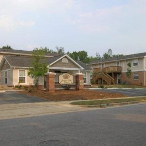

            BTW - there are city owned apartments that rent for $400 and up within a block.  These are small apartment buildings that were recently refurbished and actually look quite nice.

      Matt | Sep 16, 2005 03:41am | #18
      >> Why don't the first floor window heads align with the exterior door heads ? <<
      Around here, that's more for inexpensive homes - say around $100 - 120k.  When I build homes with 8' ceilings the windows and door tops do align.  In historic homes the ceilings are usually higher, and the windows are typically higher than the doors.  These houses have 9' first floor and 8' second floor.  Actually, most low-mid $ and up houses have 9' ceilings on the first floor - even in surburbia.

        Matt | Sep 27, 2005 01:53am | #30
        Ok - Here are some more pics.  These are of the more expensive house I'm building down there in the city.  First is the dormer that I built inside the house.  Then the framers came back and put it on the roof.  The next is of the front elevation - the pic's low resolution makes the siding look funny.  Siding is done except for a few pieces that had to be left off to support sucessive steps - like porch ceiling is not done as the electrical needs to be done and the building inspector is gonna want to look up there after all rough-ins are finished and signed off.  Rough-ins are going on right now.  Once the plumber and HVAC get done, then I'll have it painted.
          Matt | Sep 27, 2005 02:02am | #31
          To give a little more background on the project here is few pics of houses in the hood a few blocks away that will likely be replaced or refurbished.  And one pic of a neat looking house over there - there are a few.

            Matt | Sep 27, 2005 02:32am | #33
            And here are some high density rental units that were refurbished.  They are right between "my" neighborhood (OakHood) and the Hood.  So, it's not like all the old residents are being displaced...
          3. DougU | Sep 27, 2005 06:04am | #36
            Matt
            I envy you.
            I've always like to see old neighborhoods being revitalized. Most of these houses are well built and its a shame to let them deteriorate to the point of disrepair.
            Keep the pictures coming.
