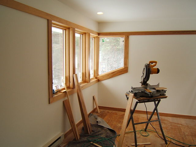

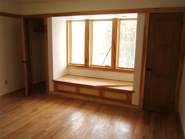

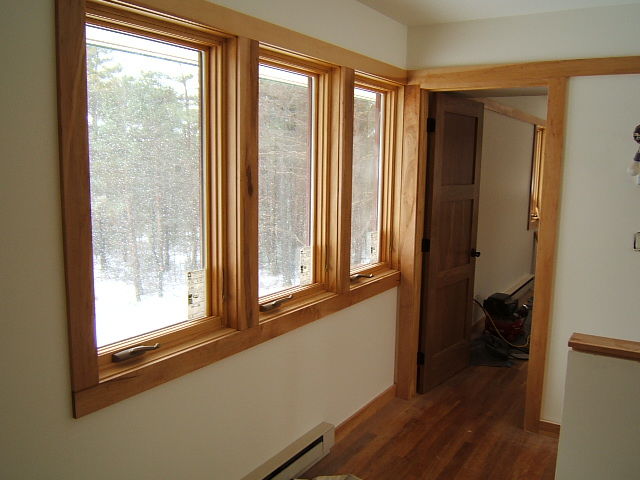

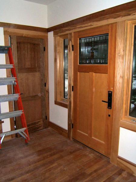

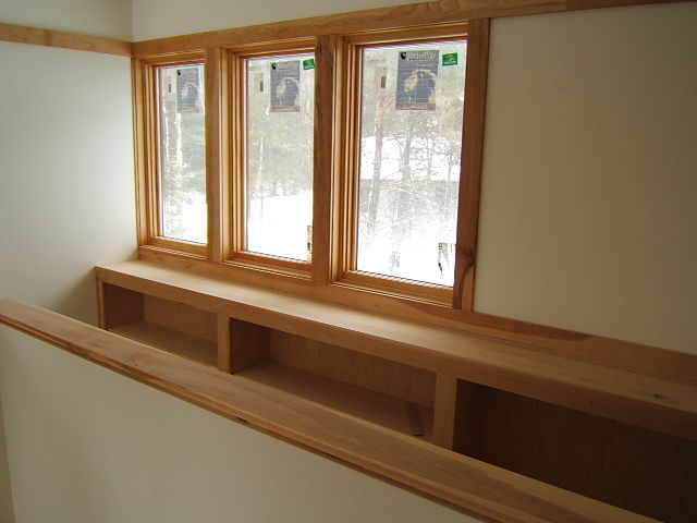

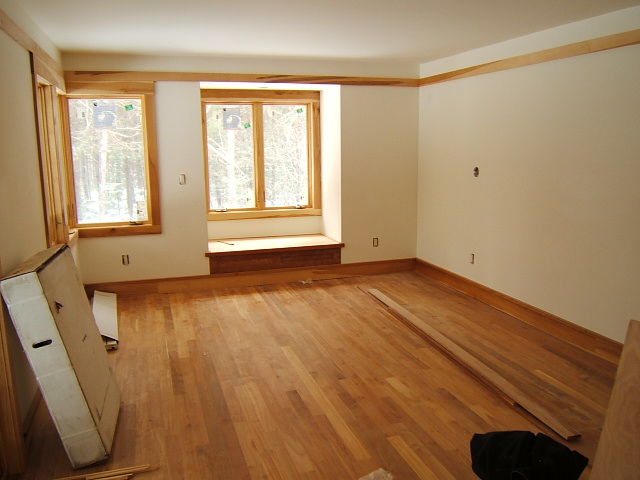

Looks great. What kind of wood are you using for base and window trim ?
What you see is mostly "brown" maple. Not selected for the all-cream color, and differentiated from clear "sap" maple, it has loads of character.
Plus, it costs a whole lot less than sap maple.

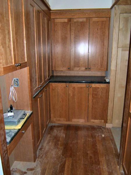

The 5/4 x 1-1/4 base cap is cherry. Cherry trims the parlor, which is the room with the eyebrow over its fireplace, the kitchen, and adjacent pantry.

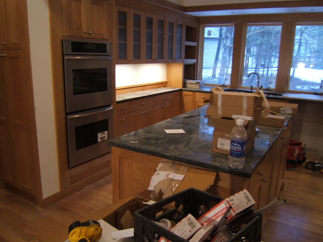

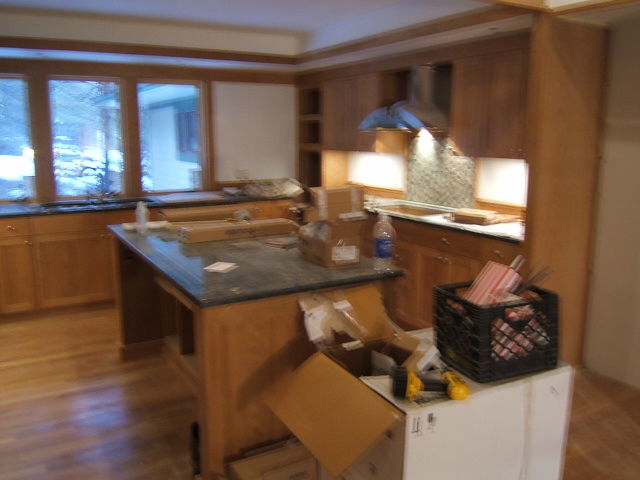

The cabinet order, all KD, was about $45K. The millwork order was close to $16K.

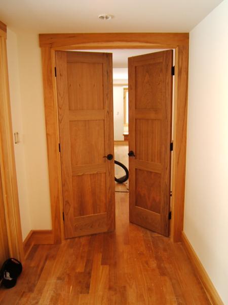

Those three panel interior doors; tell us a bit about them.
And the wood floors?

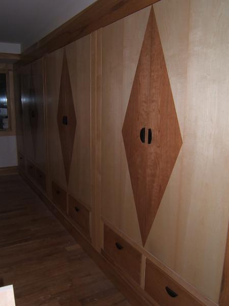

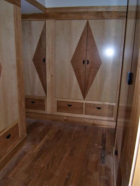

And tell us a bit about these doors and drawers and there function.

What you are seeing is a part of the dressing hall. It is L-shaped, and in total, contains 5 of those 48 w x 60 h wardrobe cabs, and each cab has a deep drawer on full extension slides underneath. One single 24 w cab is at the end near the window.
In addition, the hall has a 65 w recess where the plans call out a built in dresser, with mirror over. The clients deleted the built in, and will place a dresser there that they own.

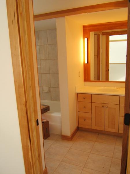

The three panel doors are from Stallion Doors, are made with particleboard or MDF cores, and are veneered in cherry. The distributor, Drew Supply, prefinished them.
Floors are red birch, one grade down from select clear.

I see you got your doors with the triangle's on them. Did you find someone on here or knots to do it? I remember you asking.

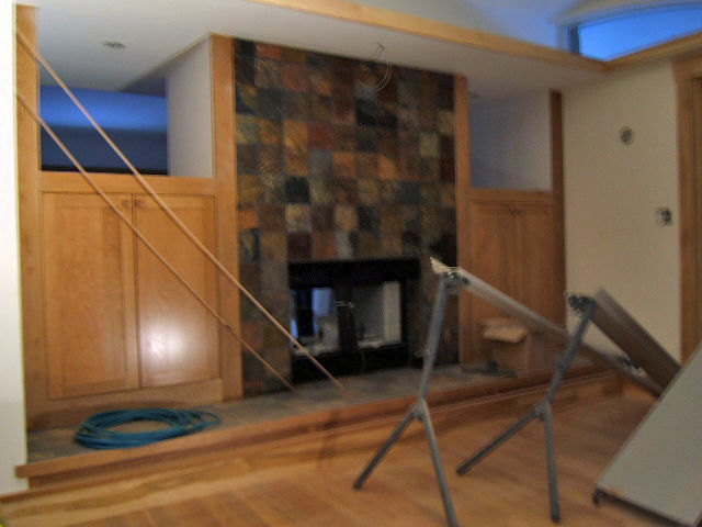

The mantle came out real nice, did you do it or was you able to find someone locally to do that?

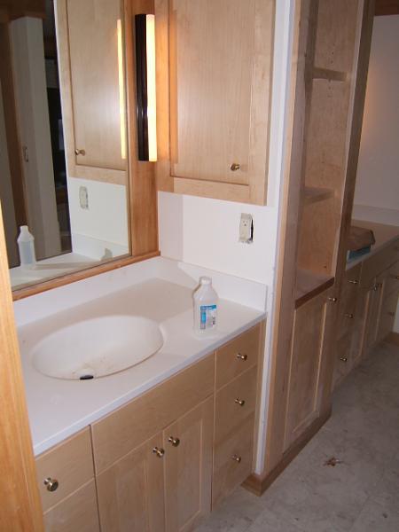

Are all your cab's from Sherr's (sp?), doors? I know you like them, just wondering. They really look nice, your revels appear to be dead on!

That curved mantle is very nice. Post a few more pics if you can! Jake Gulick

Thanks, Doug.
The doors came from David Christian's shop in Lenoir, NC. Nice veneer work, eh? David shipped them fully finished and machined for the Blum hinges.
Hal Moore, of Saranac, NY, made the mantle. Hal used a vac bag to press the 1/8 shop made "veneer" to the top and bottom. I supplied the paper patterns for the shape, plotted from my CAD file. It needed a 1/4" end trim for installation. I took a deep breath before triggering the skilsaw.

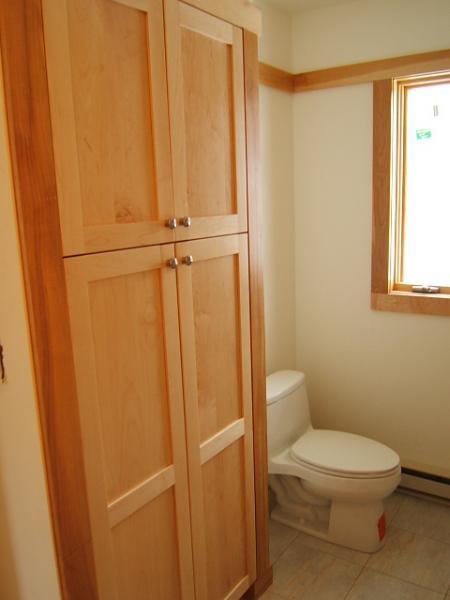

The entire cab order is from Scherr's. Not one mistake, and it was a big order.
