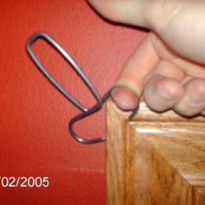

Pictured here is a fairly easy way to use the clamps without the pliers.
1. glue and pin the miter to keep the pieces lined up and then squeeze the clamp open with your hand.
2. set one point about 3/4″ below the outside corner of the miter.
3. grab the loop on the side of the clamp opposite the point you just set.
4. pull the second point over to the other side of the miter and set it–done.
5. this pic shows the easy way.

Thanks, it works better with two hands...you should have seen me doing that and trying to take pictures at the same time <g>.
Hey, thanks again for the technique. I used my Collins clamps all day today- I'm sure glad I got a dozen, because I was using every one of them. For a lot of the door casing, I was gluing up on the floor, then installing when dry. For that, I could just squeeze one handed, and tighten it up with both hands if I needed to- usually I didn't.
When I was doing windows (some of these window sets are 10' long), I couldn't pre-assemble, so I used your technique. Worked great. I don't think I'll get the pliers for now- I hate to have another thing in my toolbelt. I'd probably get the pliers if I ordered more clamps in the future though.
