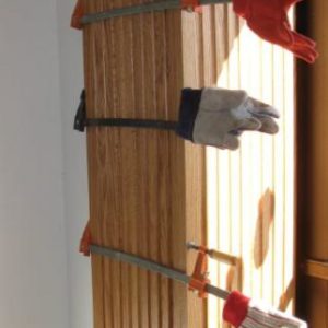

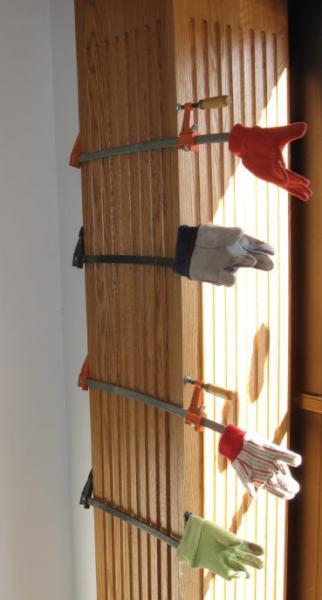

          Rich,I really like your drying racks and will use that idea. Thanks for the tip.Here is a funny tip, related to the column project... I had one column joint open up and re-clamped it in place (in a busy hallway). I covered the ends of the clamps with unmatched, brightly colored gloves, to warn people to avoid running into the clamps.Looked so funny, I had to take a pic:
          1. cargin | Feb 09, 2009 06:37am | #33
            Basswood
            That's funny
            Rich

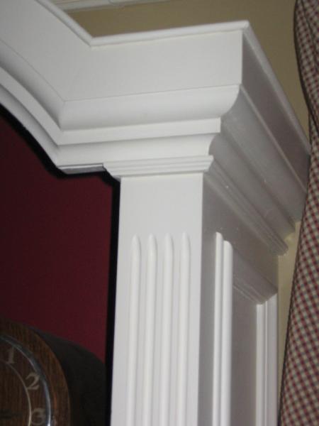

      Jeff,These pilasters, since they wrap around the corner, have more depth than a typical "flat" pilaster... almost a column.Here are some pics of one with the capital added:
        Ted W. | Jan 28, 2009 06:08am | #9
        Just curious, did you shape your own moldings for the capital or are those off the shelf?~ Ted W ~

          basswood | Jan 28, 2009 06:16am | #10
          The moldings are off the shelf. From the top, 3-1/4" crown, then a chair rail molding, and just above the flutes--an inverted base cap molding. There are two layers of 1x building out the capital too.I hope it looks OK. I took some cues from the columns I was "copying" and tweaked the design some.

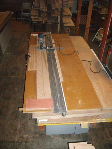

          1. mikeroop | Jan 28, 2009 06:28am | #11
            Got any pics of routering the flutes? jigs? ect?
            basswood | Jan 28, 2009 06:47am | #13
            Mike,I used a Bosch router with EZ guide rail. These are some pics of it when I was fluting for 8x8 columns:

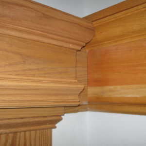

          Thanks Henley,I also had a conflict between the new capital and the old crown:

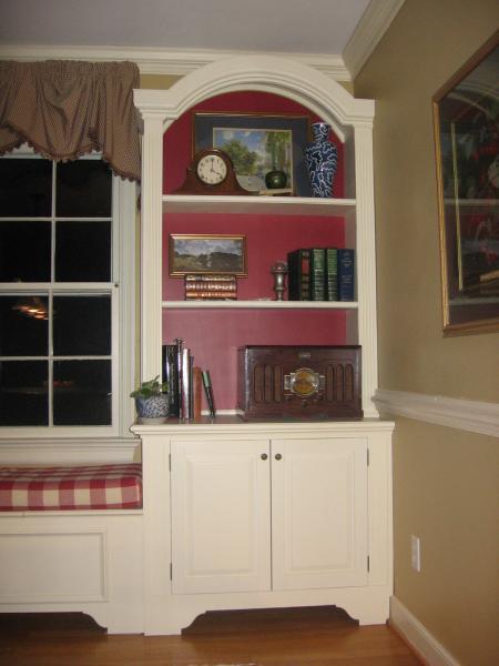

  4. rpholland | Feb 02, 2009 03:56am | #25
    When I make fluted pilasters I like to taper the ends of the flutes. I have attached a picture of a built-in bookcase that uses this type of fluted pilaster. Instead of a stop block for the router, I made a tapered piece at the end of the flutes that gradually lifts the router off the work piece. I like this method of terminating the flutes.
    Robert
      basswood | Feb 02, 2009 06:02am | #26
      That is a good look.In this case, this foyer and adjoining hallway already had a dozen existing columns with flutes that I was matching.
