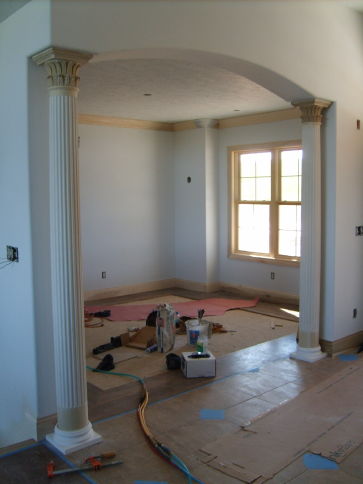

            basswood | Jun 19, 2008 02:44am | #13
            Steve,Thanks for sharing the nomenclature.Here is the result of my efforts this afternoon:
            Sphere | Jun 19, 2008 02:50am | #15
            That don't look quite right. The flutes start too high up from the base.
            Look here.
            http://www.columns.com/co_replication_columns_pop.html
            The ones I am doing are the very last in the lineup
            Edited 6/18/2008 7:52 pm ET by Sphere
            basswood | Jun 19, 2008 03:07am | #16
            Well, it could have been worse...I cut 16" of unfluted area off the bottoms of these columns.
            Sphere | Jun 19, 2008 03:18am | #17
            Holy smokes!  I'd say somehow that was wrong..lol
            I edited the last post to show that I am working on the last style in the lineup, and outta curiosity I priced a new column..118" was 1475.00, I rebuilt the wood one in a day.
            They do do make custom sizes.Spheramid Enterprises Architectural Woodworks
            basswood | Jun 19, 2008 02:57pm | #19
            Sounds like you did well on your rebuild.As far as custom columns go...this stuff is already on the job and I just install..."semi-custom."Once they are painted, I think they will look better.Thanks for the input,BC
            Sphere | Jun 19, 2008 03:14pm | #21
            I'll have a pic or three when the camera recharges later, cutting the base rings round and profiling today.Spheramid Enterprises Architectural Woodworks
            mmoogie | Jun 19, 2008 05:29am | #18
            Brian,Nice work. They certainly look better with the necking right up under the acanthus leaves. Most of what passes for classical columns these days just looks wrong, and one of the most glaring errors to me is the way they handle the necking. Not sure why they do that. Probably just to give some adjustment room...probably the same reason for stopping the fluting short of the base too. I don't think the bases look too far off in your case though. One of the biggest problems with trimming too much off the bottom is that it messes up the entasis, which they usually don't get right from the git-go either. There is a really neat way to get the entasis right if you ever need to do a pilaster from scratch...can post if you are interested.Steve
            basswood | Jun 19, 2008 03:04pm | #20
            Steve,I bet these columns get the capital added right on top fairly often (I cut 4" off the tops and 16" off the bottoms). Some folks just would not want to cut them twice...aesthetics...What?These columns came with a warning "don't cut more than 1/3 off the bottom" or something like that. The reason given was that the base would not fit (no mention of entasis--that would just confuse people).Feel free to post more on entasis (all I know about it is from a PBS special on the Parthenon).Have a good day,Brian
