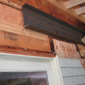

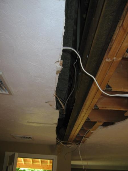

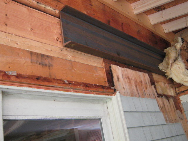

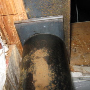

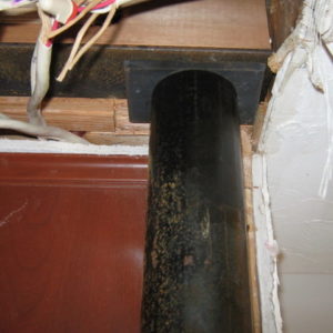

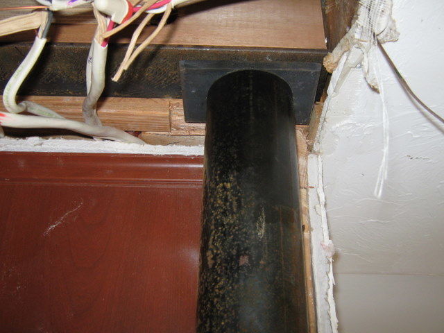

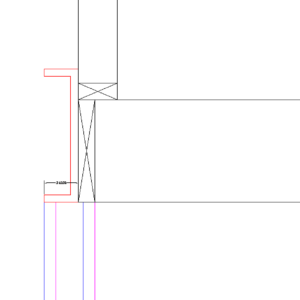

Have a Steel 12 x 30 C Channel installed and now installing the steel posts (3.5 dia) to support them.
Wonder what people think the optimum placement of the Column is under a Channel. Obviously with an I beam you center the column, What is the center of the Channel.
Attached are a couple of pictures and a drawing of the situation.
Right now I am thinking that the center of the column would be best somewhere around the inside edge of the web.
Thoughts??
  1. toolin | Jul 19, 2009 05:40pm | #1
    May have answered my own question, found this site that shows the center of the channel Cx It shows .674 in from the flat side.
    Pretty close to my guess.
