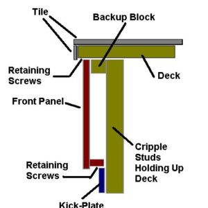

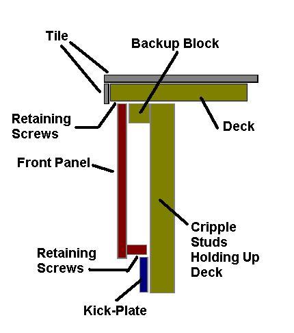

      The facet (Delta) is mounted on top of the tile - 1 1/2" inch holes drilled in the tile and the deck. The facet comes with a mounting kit that can handle anything from 3/4 to 2 inches.  Once the mounting kit is installed, you put the faucet on it - sealed with an o-ring.
      For plumbing access, I cut out a 12x18 inch piece out of the cabinet next the to the tub, then mounted it back in place with a couple of metal straps.
      The full front panel is removable in one piece. It's held by 8 retaining screws that are hidden under the tile lip and the kick plate. I needed to do this to get to the whirlpool motor. You could do a tiled board instead of the panels.

          Here is a diagram of how the front panel is attached.
