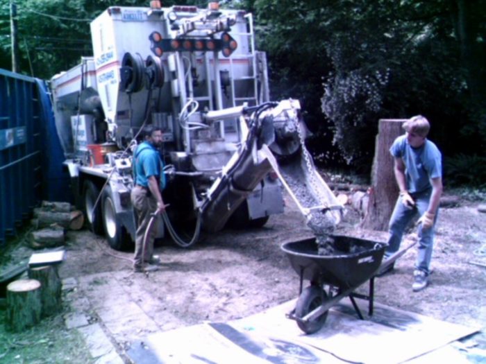

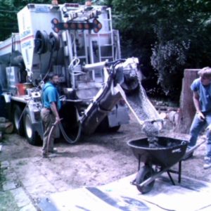

Renoun | Posted in General Discussion on June 1, 2006 07:49am
I had 1.1 yards of concrete delivered today. Neat operation, basically a little truck mounted batch plant with a water tank, a aggregate hopper, a cement hopper, and mixing equipment. They meter as they mix and only charge for what is dispensed. Handy for our little pour consisting of a 36″x36″ footing and post plumbing basement slab repairs. Sorry for the photo quality, I didn’t have a real camera with me.
Edited 6/1/2006 12:51 am by Renoun
