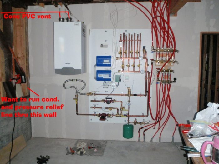

I have a mod-con boiler and need to route the condensate and the line from the pressure relief valve.
The condensate line is 3/4″ PVC can I route it to gravity drain thru the wall and just drain it into the ground outside?
The pressure relief line-has to withstand 250 deg temp so I’m guessing only copper for this?  I would like to run this line out thru the sidewall of the house and have it terminate slightly above the ground also is this acceptable?
If I have to drain these things into a sanitary sewer I’m screwed cause the nearest line is on the other side of the house…I could use a condensate pump but prefer to gravity drain everything.

    madmadscientist | Jan 27, 2009 04:21am | #1
    Here's a picture of what I'm talking about.

      PeterJ | Jan 28, 2009 05:22am | #11
      Look your manual over closely, on the Munchkin Contender I installed they nixed gravity drain to freeze-possible area. Solution was to drain into cond. pump and pump out to same spot.
      Inspector was OK with  dumping outside. I did dig a small pit and filled with 3/4 gravel, the whole area is gravel anyway. The boiler puts out a fair amount of condensate, might make mess on dirt or skating rink on concrete.
      Yes to copper on P&T, here you can use CPVC, but copper mo betta.
      Going on three months now, works fine.

            Warmer climates usually allow the t&p Vv to be discharged outside (12" Max 6" Min). No Unions, Valves or a reduction in size is allowed here. Colder climates (Where it may freeze) have the discharge on the interior. As for the condensate line you will have to contact your building official/inspector and ask him. It might need a neutralizer bath before being discharged. A lot of municipalities don't allow you to discharge the condensate into the municipal waste system anyway, that's why it's important to contact a local building inspector. Hope this helps.
  3. rlrefalo | Jan 27, 2009 06:08am | #4
    Daniel, condensate drains are sometimes drilled through the basement slab and allowed to drain into the stone base, or eventually to the sump pit.
    Do NOT pipe a T&P relief valve in such a way that could form a trap. In cold conditions this could freeze and under the right (wrong?) conditions cause a boiler explosion.

    Chck with your local code folks - note on the T/P valve, the drain pipe HAS to be at least the same diameter as the valve discharge

    They get freaky around here if the pressure relief piping isn't inches from the floor due the chance of scalding. Can't imagine they would be too thrilled with you shooting steam out the side of your house at unsuspecting people.
      madmadscientist | Jan 28, 2009 05:13am | #10
      Well obviously, I am talking about bringing the line thru the wall and then having it turn straight down ending a few inches above the ground.  I want to do the same with the condensate line from the mod-con boiler.
