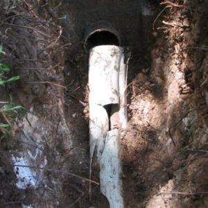

      1. sleddriver | May 24, 2008 08:54pm | #4
        Here's a photo of the pipe glass'd into the tank:
        1. brownbagg | May 24, 2008 11:10pm | #5
          quality work for a sh%t job
          1. sleddriver | May 25, 2008 12:53am | #6
            I've been down in the hole enough on this project. Glad to climb out, fill it in and be done with it.
