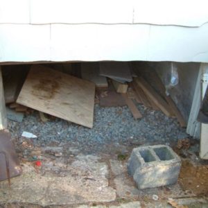

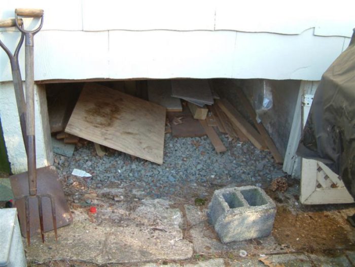

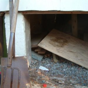

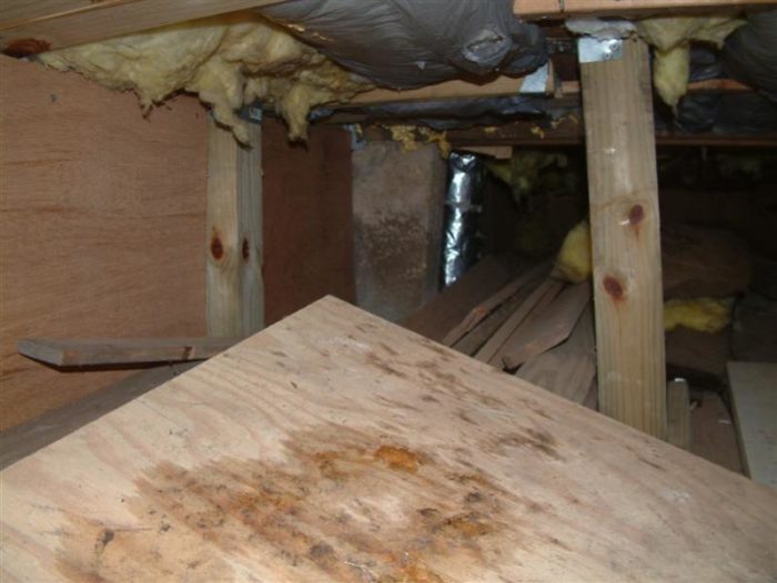

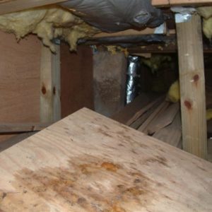

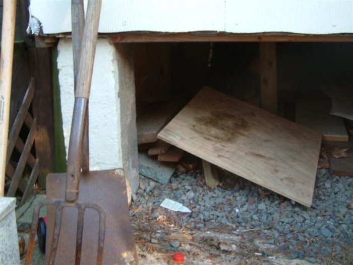

I am planning a 400 sqft addition to the back of my colonial home.  I have a full basement which is poured concrete walls, as well as pier footings which extend the house a few feet followed by a crappy deck.  I want to remove the deck and extend the gable end an additional 20 feet, but I am not sure what’s the best method to connect the foundations together since there is a crawl space under the back of the home now.  Ideally I would like one continuous foundation with a basement, but I am not sure that is feasible.
Can someone suggest how I can accomplish this?  I am concerned that when I dig next to the pier footings when I try to pour the new foundation, that the pier will simply fall over since it is only anchored to the house.
I have attached some pictures to show the pier footings and the main foundation.

  1. timkline | May 08, 2008 07:49am | #1
    it is feasible, but it would mean shoring the part of the extension currently supported by the piers so that the piers can be removed.
    then while it is shored, you will be digging under the extension back to the house foundation.
    putting a full basement under this addition could get expensive.
    an enclosed crawl space while less desireable would be more reasonable.
    it just depends on how important that additional 400 sf in the basement is to you.

      1. timkline | May 09, 2008 12:31am | #3
        you need to support the floor system with shoring and remove the piers.
        pouring concrete walls up to the bottom of an existing structure is not the easiest thing to do but the fact that the walls will extend beyone the existing structure will definitely help.
        if you use a 6x6 wood timber as a temporary support beam, you may end up having to block form around it which will leave a hole in the wall that will need to be patched after the forms are stripped and you drop the structure onto the new wall.
        you may be able to support the wall or roof system from the sides and then strap the joist system to the walls to ensure that it hangs. this would eliminate the beam going through the pour.

          1. timkline | May 09, 2008 02:46pm | #5
            yes, you could do that.
            i was going to suggest it as an alternative, but with a twist.  i would suggest shoring the structure with a wood beam, remove the pier and then underpin the structure with the concrete block.   after the mortar has set up overnight, you can pull the shoring beams and then fill in the holes with your final blocks.
            PT 6x6's work well for this (depending on the span) as they are less than the height of concrete blockcarpenter in transition
