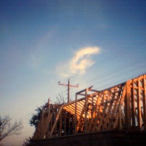

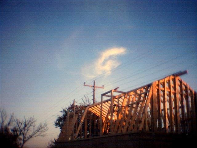

I’m building a 16’x32′, two story Gambrel Roof storage shed.
On the second story, after both sides of the rafters are nailed to the ridge beam, I heard some builders use a metal strip to go over the ridge beam and tie the tops of the rafters together. Will doing this add a lot of strength to the ridge beam area?
I have some metal wall studs. Would the metal running about 2ft. down on those studs be heavy enough to tie the two rafter halves together?
