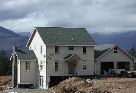

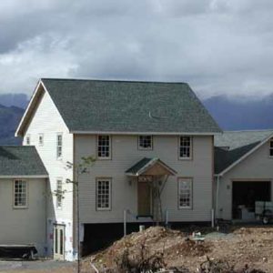

          I just completed my house in the Seabeck, WA area using 6 1/4" siding with a 5" reveal, I used a Skil 77 wormdrive with a blade designed for the Hardiplank.  I found that if the material was a little wet (NOT a problem this time of year as you know) that the dust was next to nothing and you just have to be a little more careful when handling the long boards as they have more flex when wet.
          They are right about cutting with a standard hole saw, the bits only last a couple of holes than they need to be resharpened.  I did see a diamond coated saw blade for a reciprocating saw that looked like it would do a great job for some of your trim work, but I was almost done and could not justify the extra cost for the little trim work I had left.
          I attached a couple of pictures to show what the end result was.

          1. xMikeSmith | May 14, 2003 12:05am | #18
            jason.. any closeups of the trim details..
            what are those things on the horizon?  we ain't got nothing that looks like those in RIMike Smith   Rhode Island : Design / Build / Repair / Restore
          2. Snort | May 14, 2003 03:47am | #19
            Doh, goes to show ya why reading comprehension insn't part of the carpentry test here...thanks for not pointing out my attention deficet.

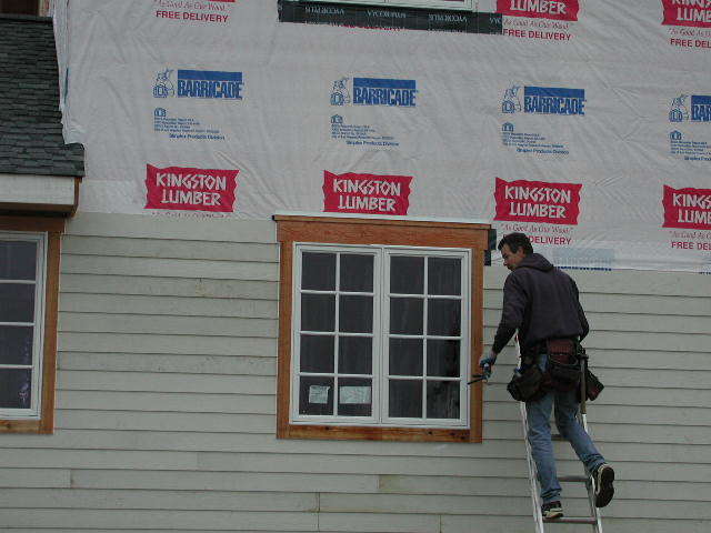

          4. blackcloud | May 14, 2003 07:45pm | #23
            Mike,
            This is the only, other picture I have, if you would like a specific detail I can see what I can do.  By the way the big things in the back ground are called mountains, I am originally from Mass. and I thought the hills back home were mountains until I got to see some real mountains.  I added a picture of my view from my bedroom.
            Jason
            sorry about the size of the photo. jwIf it wasn't for bad luck I wouldn't have Any!
          5. xMikeSmith | May 15, 2003 02:38am | #24
            thanks... that's what i wanted to see.. the casing details... cool
