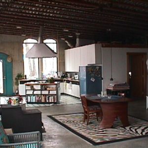

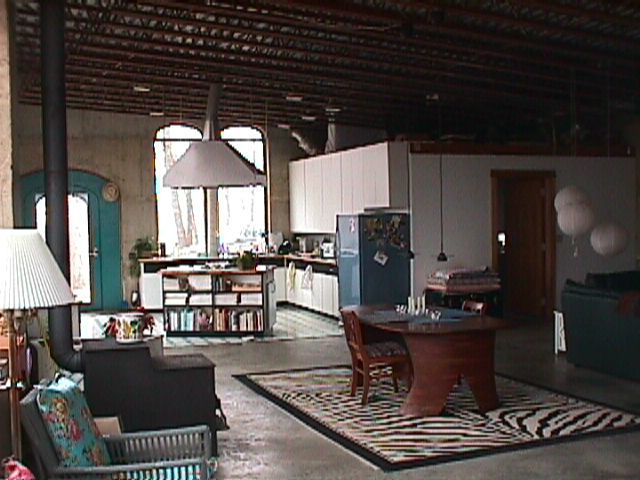

    Yes.  Ours is 3' x 4', 44" up with a remote fan.  Works great.  Don't know the cfm of the fan as it's recycled (as was the hood), but it moves a lot of air, quietly.    I added more light inside the hood as it cast a large shadow.  No complaints.
