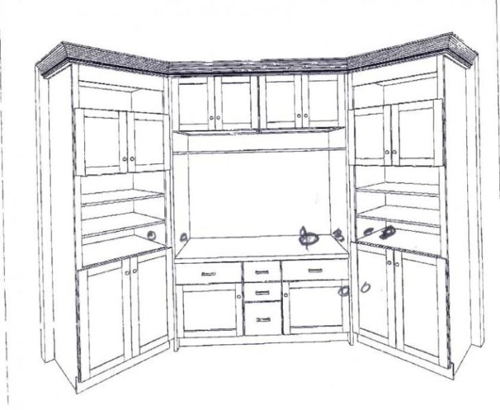

I am wondering if you go to the trouble of coping inside 45 degree corners (22-1/2 degree miter) for crown. If my angle finder tells me they are really 45 degrees I have just been mitering these corners. Coping these requires removing lots more material from the backside of the molding and is more trial and error in the fitting phase (or am I missing something). I have been doing more and more of these (mostly crown on kitchen wall cabinets with 45 degree corner wall cabinets).
I have an entertainment center to do where people will spend countless hours staring in the general direction of my molding joints so I don’t want miters to open up as things dry and shrink.

      The unit will be built-in, assembled from a bunch of semi-custom cabinets.The crown will come prefinished with the cabinets. But the last prefinished crown I used from this company shrank enough to open up scarf joints on long runs as it dried out. At least in this case there will be no scarf joints and the longest run is 54". So a nice fitting and well glued miter will probably be fine. I just get nervous when I know how much attention these miters could see. I worked for a builder who had me sit on the toilets in custom homes he built to get the crapper eye view of things--since some people spent a lot of time there--with out much to do except look around. At least with an entertainment center there will usually be something else to look at. I'll make things fit well on this one and hope they don't open up later.

          I thought about that; to some extent, I can. The two ends are like tall pantry cabinets, the center is built up from five cabinets and two tall end panels. Most of the work on this is really being done at the cabinet shop. My part is like stacking childrens play blocks (nice and tight) and scribing and trimming it in. It butts into a rough brick fireplace on the left side. Scribing that in will be half the job.
