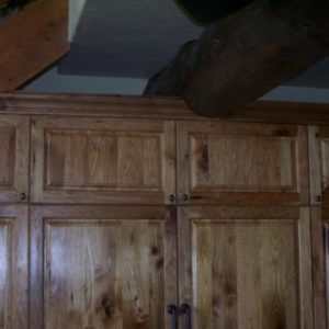

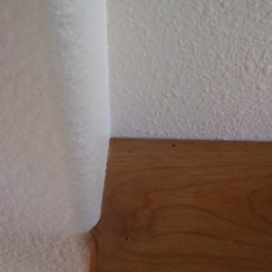

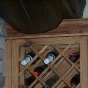

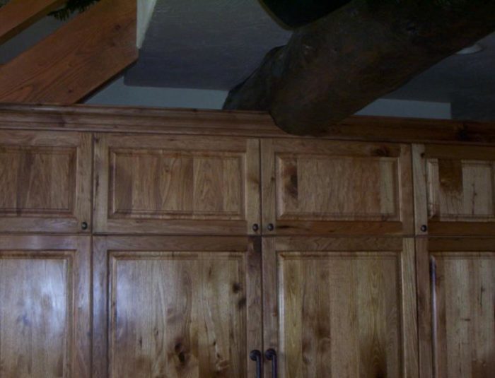

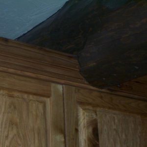

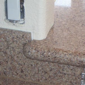

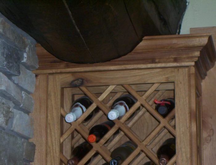

        1. tsquaredframing | Jun 09, 2006 06:35am | #15
          I used quickgrip clamps to clamp to a ply table or other such surface on sawhorses.  The cool thing about a Lancelot is that the cutting surface is the edge of the tool instead of the flat face of the disk.  Examples of crown copes done with Lancelot attached

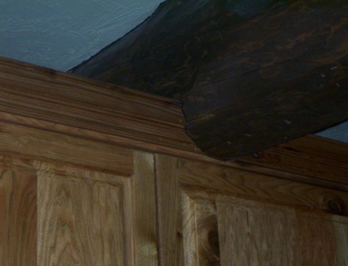

    1. tsquaredframing | Jun 08, 2006 05:25am | #8
      Have never tried the biscut jointer blade on a grinder but am very adept with my Lancelot chainsaw wheel.  I've coped crown to logs, base to logs, 1x alder mantle top to drywall w/bullnose corner and lots of other wood products.  It is very aggressive and would only recoment a grinder with a paddle type switch, years ago doing log work we used grinders with switches and these blades were nearly fatal at times.  There is a learning curve but with some practice nearly perfect copes can be obtained.  Tomorrow I will take a few pics and post them.

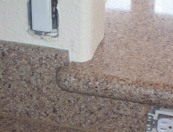

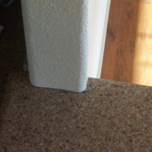

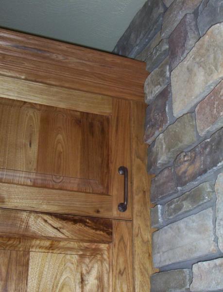

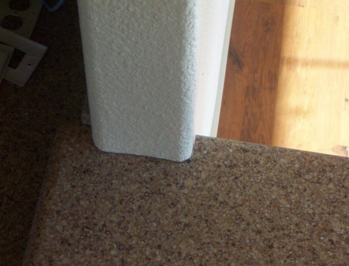

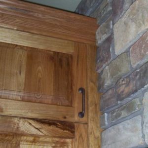

          3. tsquaredframing | Jun 12, 2006 07:21am | #25
            More scribed pieces made with angle grinder.  The synthetic stone was done with a diamond wheel.The difficult we do right away, the impossible takes just a few minuts longer
