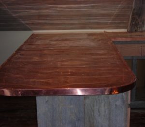

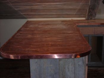

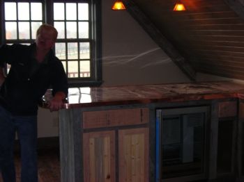

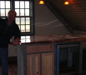

Got this project dropped in my lap Wed night and we ended up installing them Sat morning. Things were pretty messy on the job site and the lighting was bad, so I hope to get better pics when I go back next week to finish.
That’s Mike – the project manager. The top is covered with sawdust from the sink cutout.
This picture is weird. Those “ripples” were not visible in real life. Must be a reflection from the beaded t&g above.

    Sphere | Nov 12, 2007 02:06am | #1
    Thats way cool.. Is that a raised edge?  How'd ya do that with out a crinkalater on the bends?
    "If you want something you've never had, do something you've never done"
    1. seeyou | Nov 12, 2007 02:15am | #2
      It's "crinkalated".  The other side (it's a "U" shaped top) has a 2" radius. It came out fine. The light really sucked in there.http://grantlogan.net/
