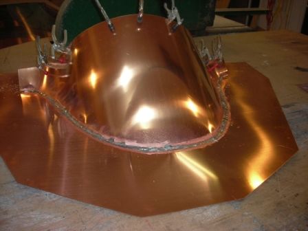

Just shipped ten of these off to the home of Rice-a-Roni today. Duane made the carcases for me. These were a bit of a challenge since they were so small and because of the reverse curves. Here’s one with the lovers and face plate installed sitting on the base:

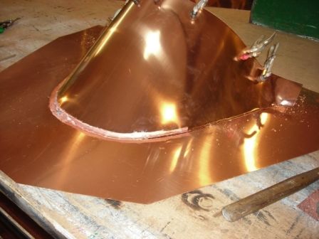

The top is then clamped off. I used Sketchup to lay out the top. Cut a cardboard template and test fit it a couple of times until I got it right before cutting any copper.

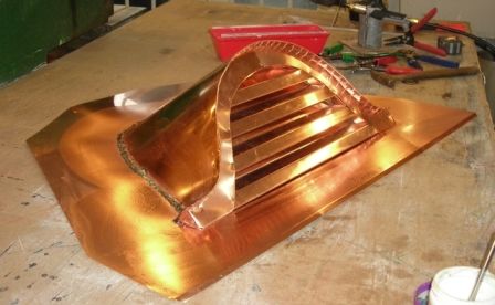

Here’s a view from the back, fluxed and ready to solder:

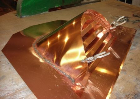

and soldered:
