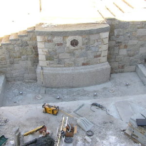

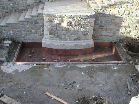

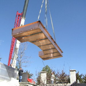

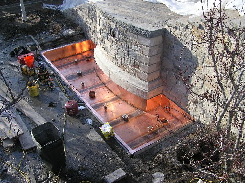

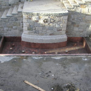

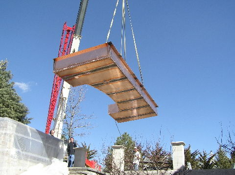

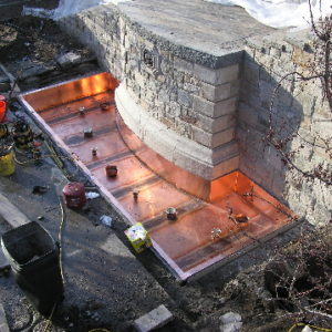

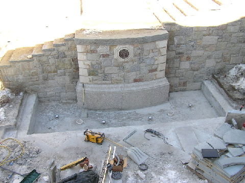

This is a copper liner I completed this week. It took 3 weeks to complete. I had to jack hammer out all of the fixtures in the existing concrete floor and prep them for my pan (yes it’s new work but the architect didn’t think of a copper pan until after the concrete was poured). I then made a pattern, fabricated the pan, installed it and patinaed it.
Sorry for the file size on the pictures. If there’s a way to make them smaller without distortion please let me know. Also you should start with “the hole” picture first, I posted them out of order. |

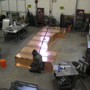

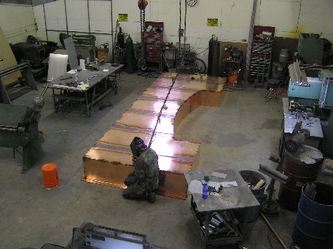

Nice job, how long did it take you to TIG it ??? We do some aluminum and it is pretty time consuming .. can't imagine doing all that copper ! Bill Koustenis

It took only 5 days to cut out, tack together and weld on both sides. Roughly 90 feet of welds. The Helium is the trick, it makes preheating 1/8" copper unnecessary, it cuts down the distortion by 80% compared to preheating with oxy/acet.. It also cuts down by 80% the discoloration which hastens cleaning. I don't understand how it concentrates the heat so intensely on copper, but trust me it does.
