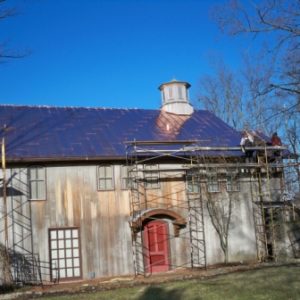

Dale brought these pics in today. We’ve been working on this roof in between storms. It’s a converted horse barn. We tore off a cedar shingle roof, some of which I did (an addition) about 15 years ago for the previous owner.

Looks great!
Do you make your panels on the break, or do you have a roll form machine?
It's all brake formed.http://www.quittintime.com/ View Image
How is the ladder anchored to the roof?

Magnets.Spheramid Enterprises Architectural Woodworks
Ridge hooks or vice grips.http://www.quittintime.com/ View Image

How would we ever do metal roofing without chicken ladder!?I have one that I glued some 1/2" wool carpet pad to for scratch prevention. Thought it would end up coming off, but after three years it is stil fine, not that I use it evry day...
Would some kind of rubber strip be better? Keep you from scratching the roof and maybe help the ladder stick to the roof better?

No one brought up what we do/did on the side of the roof that is yet to have the copper to clamp the vise grips to. If you can't get a ridge hook to work, due to length to the ridge or on a hip, we screw the ladder to the roof. A few pilot holes in the rail flange and a few Piffen screws..yer good to go. You have to screw the bottom screw, then with just it holding go up and add another. So your life hangs on one screw for short time
(They are actually deck screws but I wanted to see if Piff would get his feathers ruffled.)
I think Dale is about 220 and I'm 170 and with both of us and tools, we've been on the same ladder with two screws holding it down..the weight really is on the roof.Spheramid Enterprises Architectural Woodworks

With the right shoes and walking duck toed, anything up to an 8/12 is not bad..get up over an 8 and you tecnically can walk it..but not for long, it wears ya out. I could climb on a 12/12 using the seams, but getting down is scary.
Dale also has a lower center of gravity, I think guys like that can do better roofing, than us tall , skinney top heavy guys..hell, I can get blown over in the wind on flat ground..LOL only a size 9.5 shoe too..long, but skinny..like cheap flippers.Spheramid Enterprises Architectural Woodworks
Yeah, new copper grabs nice - it's the Kynar finish that is slick as snot on a glass doorknob!;)
two pipe clamps and some 3/4 ply ,24' sq., with 3/4" holes in it. Slip the pipe through the two top rungs, clamp the ply to the ladder. No slip , no fall.

I don't want it to stick. That makes more work when I move it over each time. The hook at the ridge takes care of making it stick.
Looks great now, but that is going to be fantastic when the copper weathers a bit.

This roof is 58 sq and pretty simple. IIRC, tear off, disposal, dry-in, copper standing seam, and snow guards is about 80K. There's been several changes since we started. It was assumed we'd have to resheath with advantek. We thought it had split sheathing , but it was 5/8" plywood. The ceilings are all vaulted, so we couldn't tell 'til we tore off. Then, we had an ice storm and and snow guards got added.http://www.quittintime.com/ View Image

What is you rot for snow guards ?
I have two building with metal roofs (agri. type). After the ice storm one dumped all the ice and snow onto the fence and gate of a dog excecise area. Pretty much trashed the fence and the gate. I told DW I would e-mail you and find out the spacing and locations for them, but have slept since I told her that. (I'm like a goose,... wake up everyday and it's a new world,.... got start all over)
With Ag panels, you'll probably have to use the glue on type. I've seen them on roofs, but have never touched one. Do a search for snow guards and most brands have installation diagrams. They vary from style to style and we don't need as much protection here as they do farther north.http://www.quittintime.com/ View Image
Grant,
Are you using the clamp to the seam guards by Alpine for this roof ? Or is there a better one you employ ?
Berger clamp to seam, but I haven't ordered yet. I'll look at the Alpines. My dealer carries Berger so that's what we've used, historically.http://www.quittintime.com/ View Image
Alpine's only let you use a one bar system with copper , but two bar for steel.
I guess they feel the copper isn't able to take the stress and weight from a two bar system.
Or maybe you're using individual guards that clamp on ?
Yeah. Berger RT100 is the part #, I think. I looked at the Alpines - they're about the same. I'll stick with what I know.http://www.quittintime.com/ View Image

When you break a long eave-to-ridge run like that up into 10' long panels, how do you detail (for water) the folded flat hammered seams between the upper and lower panels, especially where the hammered flat seam meets the standing seam?
Have any details on that?

Looking at how you attach the panels to roof decking. Is there additional nailing points or longer nails when you have to meet hurricane codes?
Also, are snow guards a code requirement in some areas? Like the way they look.
We typically install nailing clips at 16" or less OC to meet 80mph wind rating. Hurricane rating calls for clipping at 12" or less OC.
Snow guards are not code required here. Might be there.http://www.quittintime.com/ View Image

Had to make a gas vent boot for the copper roof. Dale got it installed Fri and should have some pics of the finished product later.
I drew it in Sketchup for quick diminsioning. Then I laid it out on cardboard, cut the seperate pieces and taped it together for a test fit. Laid it back out flat amd cut and bent. One joint to solder:

Thats Sweet. You drew it in 3-D on sketchup then some how used that to figure out how to make it flat? Or how are you using sketchup to help you? Saves time and mistakes?
