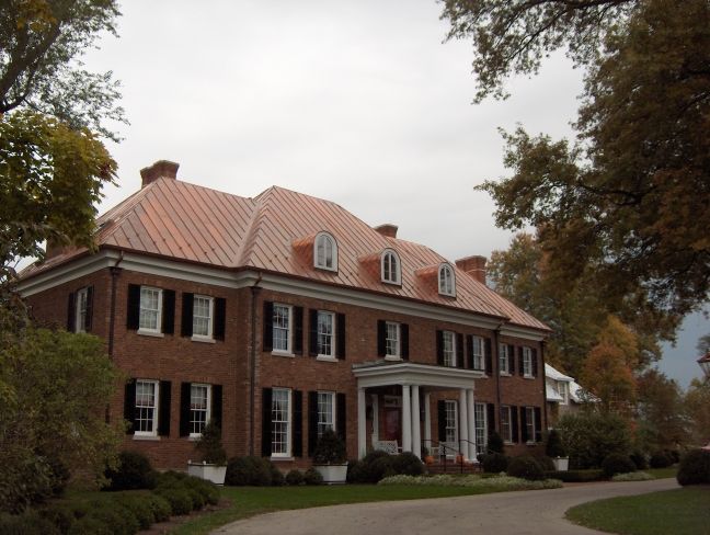

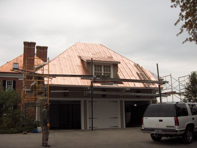

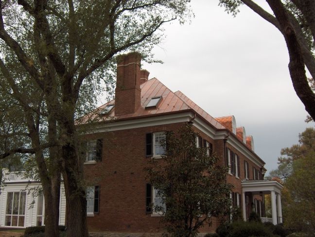

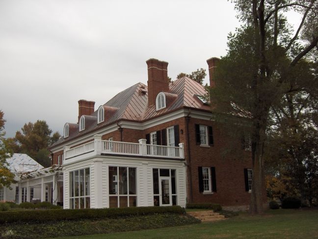

The other threads getting a little long with many sidetracks.
All that’s left is the garage and one side of it is nearly done.

Looks very nice!
That's a beautiful home. You all have done an excellent job on that roof. It's too bad we can't see the inside of that home. I bet it's just as classy as the outside.
On a side note. Will that copper roof eventually turn green like the the original did?
It will turn green, but the original was painted steel. This house is less than 10 years old.Birth, school, work, death.....................
When you finish up, do you clean the copper (fingerprints etc) with anything ?Say CU, how did you change text color in your Reply ?
No - a couple of rains will do that free of charge. It starts turning with the first dew, so cleaning it would be wasting time and effort.

The copper roof looks fantastic!!
you know, I've been posting here for at least 3-4 years, and I never noticed that bar.
That's a purdy roof.
Like copper, I'm turning green...but from envy.

Do you or Sphere have a before shot from this angle?
"Real difficulties can be overcome; it is only the imaginary ones that are unconquerable. " --Theodore N. Vail
Edited 11/2/2005 10:58 am by JohnT8

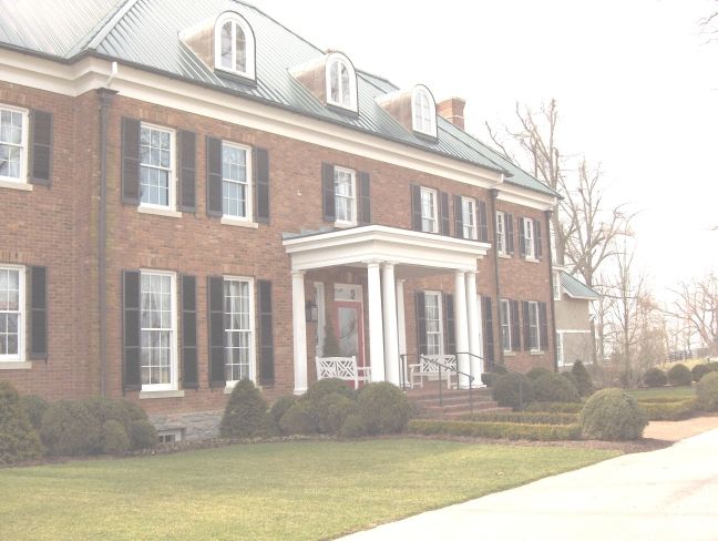

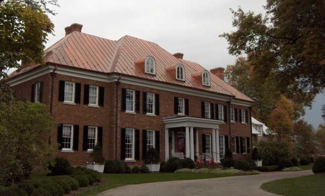

Kind of.Birth, school, work, death.....................
I tried cropping the 'after' pic to match the before, but it looks a bit dark and grainy.
A pic taken when the sun is shinning on the roof (and at higher resolution) might show up better and not animate quite so grainy. Get a better pic and I'll redo the after segment.
That's 2 kewl. Thanks, John.
I'll see what I can do. It was about to rain Mon when I took those pics. I'll probably be back out there tomorrow or Fri.Birth, school, work, death.....................

What is the cost of a roof like that compare to
steel?
slate?
cedar?
I am just curious as my home will be needing a new roof in a few year. My wife and I will probably use cedar shakes but this may be an interesting option. I am sure it is steep but have no idea how it compares to the other highend options
steel? Hidden fastener kynar is slightly less, but that's what we were replacing because of finish failure. Actually, it may have been a polyester finish.
slate? Copper is less.
cedar? Copper is about the same for 5x the life.
These comparisons are for my area, assuming all other variables are equal (proper decking in place, etc.). Birth, school, work, death.....................
Do you have any anecdotal evidence about the durability of the copper sheet vs. cedar shake? My house sits below a few trees. I am curious to know if one is more suseptible to puncture than the other.
Jason
A sharp limb's gonna wreak havoc on either. Both can be repaired. Don't really have a good answer for you.Birth, school, work, death.....................
Thats looks great...... did you form the copper yourself, or is it a premanufactured shape? How did you clinch the seams? What gauge is the stock?....Nice Work!
Yup.
http://www.nabocker.com/index.cfm?fuseaction=product.display&Product_ID=529
16 oz -weighs 1 lb/sq ft. I forget how many thousandths thick, but it's around 24-25 guage if I remember correctly.Birth, school, work, death.....................

Thank you. Yes we did button up the site. I share the camera with the DW so I don't get too many shots, and at like 400 bucks, I am lucky she lets me have it for a day!
Kind of a deep sigh getting this one done, feels right.
We are shed of the scaffold on the east plane, working on the south, need that corner tower there, otherwise iffin the boys want the east pole and NE tower of scaff, it is all free up.
Don't be bending too much more, I think we are covered till west face and then some...need hip cap and drip, ..thats all..oh, and rivets. ( and a new partner, if Dale keeps loading my pocket stash with rivet shanks, I will toss him off the roof..this is war..LOL) He is gonna get a geocel makeover iin that new tool bag..with some chicken an ribs on the side..(G) Spheramid Enterprises Architectural Woodworks
