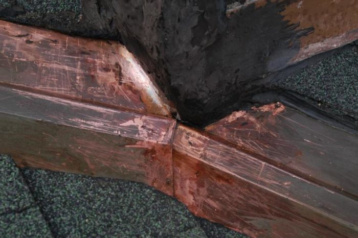

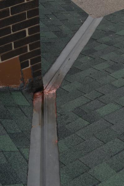

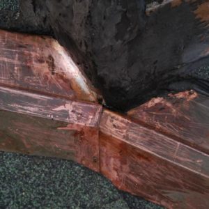

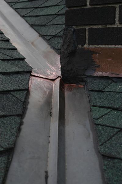

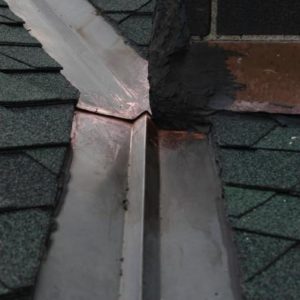

I have a copper valley that has been giving me problem from day one of new roof. I cleaned all the calk and tar that I have added over the years to give a temporary solution.
 I see why some say that calk should be only be sold to professionals!!
What should be my next step? My  thoughts are to go to a real roofing supply house and get the best silicone base roof calk and apply. Push calk between the layers of valley metal.
Or do I need to tear shingles back off and make sure the grace I&W is applied and rolled up the brick?

    But photos aside, yes, most valleys like this with a history like you describe will need to be totally redone. Without seeing yours, I have no hesitancy in stating that the most common roof leak is a valley and the most common reason is that it was poorly done to begin with.

      It's a pitch change with a chimney in the center of the valley.http://grantlogan.net/

        Ouch!!!Not really in the center of the valley, which is a gauranteed leak forever, but this one is still bad design and poor execution. It could be done, but not with a W acting as a dam right there. Definitely something for a pro to tear all the way apart and re-do, not a DIY solution!

        It will be hard to clean what's there well enough to successfully solder the chimney pieces onto the valley.
        Because of the W valley it really isn't suitable to be left in place.
        Your copper valley sheets shouldn't run more than a couple hundred- then your own labor to install or a talented roofer to solder it up for you.

    This is a situation (file under bad design) that can't be done properly without soldering. Because of the angle change in the valley, the overlap between the two pieces of valley is inadequate and if that joint is not soldered, who knows whats going on under that tar mess.
    Never ever, ever, ever, ever, ever, smear tar on good copper.
    I'd pull it all apart and make sure all the joints at the two valley piece/chimney corner junction are soldered. If you use I&WS, lap it into the valley. You'll probably have to replace some pieces that are queered with caulk and tar. Good luck.

      Sorry for the large files, I reduced them in Irfanview but I guess not enough. That is not a chimeny, but another corner of a building. This was a reroof by a contractor.
      So it sounds that the correct fix is to have it torn back, make sure I&W, and solder up the copper properly.

        When you redo this valley, use a plain V  valley ,not the W you now have.
        You should have a piece on the chimney which is also soldered onto the valley sheets .

          I kinda figured that I would have to tear the shingles back & fit a new piece of valley copper. That W does exactly what Piffin says, "dams up the water"
          I have a "collar" bent, to wrap around that corner and soldered to the valley copper. Over lap my valley materials good & I&W under neath.
