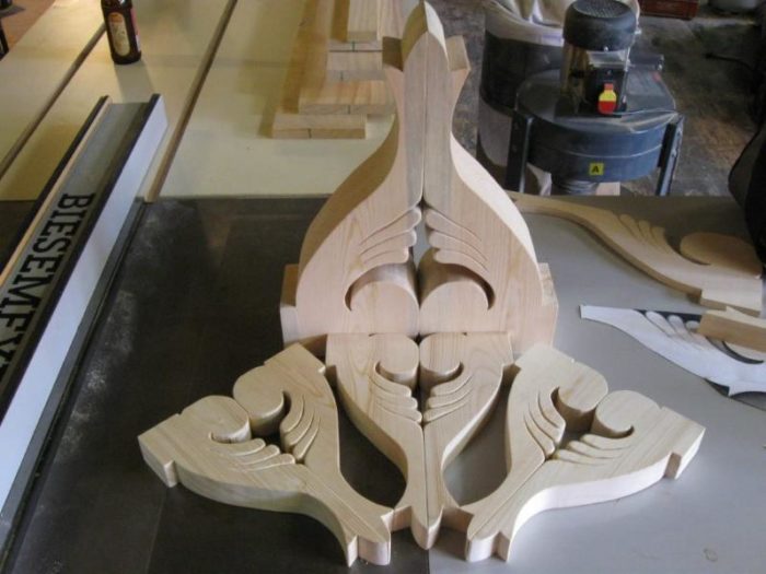

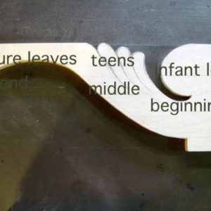

I cut and sanded 8 corbels yesterday. Still have to carve the leaves for that 3D look. I tweaked the template some before making this set (the prototype was off a bit and will make a nice bookend in the shop).
I think the three parts of the corbel are an interesting expression of the stages of life. Three parts and the middle third has three parts. One of the center leaves still curves back to “childhood” and another leans toward maturity.

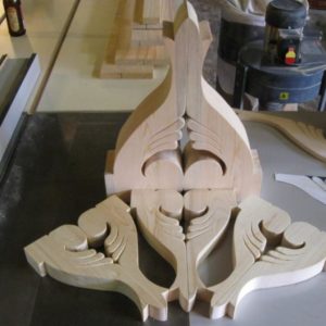

      basswood | Jul 12, 2009 11:30pm | #15
      Here is a pic of the finished product with just minimal carving to give the leaves some definition:
      1. doodabug | Jul 12, 2009 11:37pm | #16
        Very nice. pretty even
          basswood | Jul 13, 2009 12:10am | #18
          Thanks.... Enough variation to suggest that they were "hand made", I guess. They will have some space between them so they won't be quite as easy to compare installed. The originals had some variation too... so it's all good.

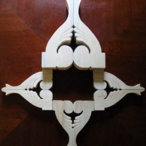

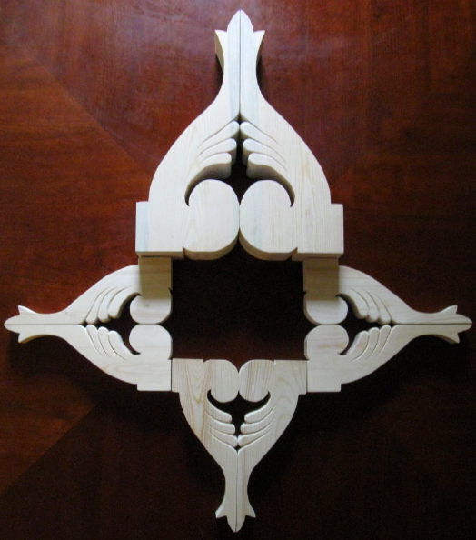

            Thanks Rich,I'll post some pics of the corbels installed... in a couple of weeks... the pergola style porch where most of them are going is just getting the deck framed now.Here is one with them arranged like points on a compass on my dining room table... I'm easily entertained:
            Sphere | Jul 13, 2009 03:19pm | #24
            Glad to see I'm not the only one that plays with my work..LOL
            'I can make a hat, a Brooch...'
            Fun stuff.
            I see wheel spokes for a funky cart..but thats just me. (G)Spheramid Enterprises Architectural Woodworks

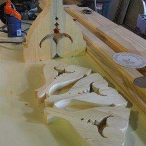

            Rich and ALL,Here is a slideshow of some process pics. Not much in the way of descriptions, but here it is:http://s436.photobucket.com/albums/qq88/knottree/floral%20corbel/?albumview=slideshowCheers,Bass
