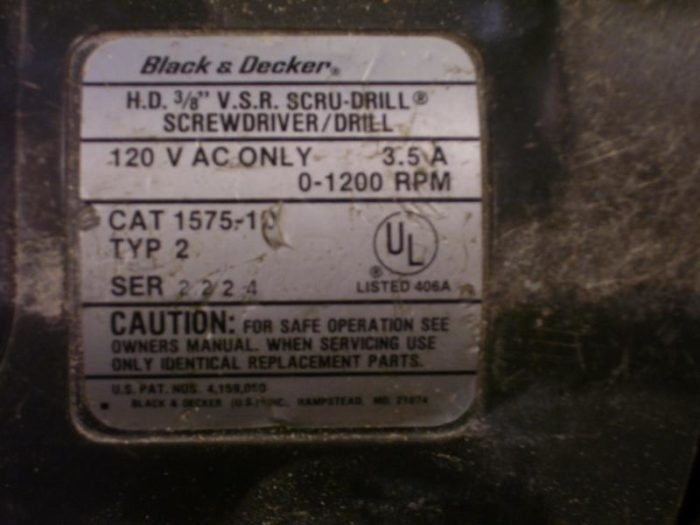

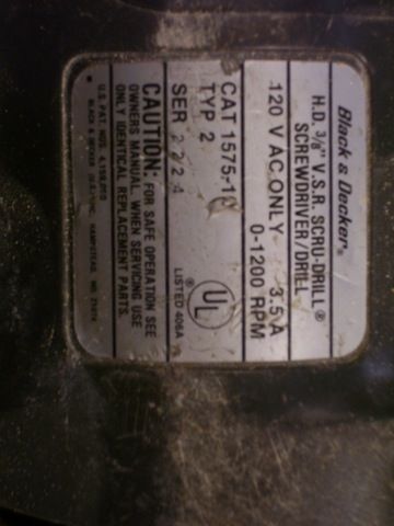

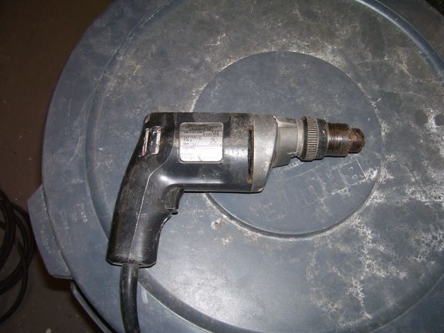

You can try looking for one of these on Craigs list/ebay or local flea market/yard sales. It's a B&D Sru Drill made back in the day when B&D made some decent industrial tools. It has a clutch like the cordless impacts,and can be locked in a drill mode. I break it out occasionally for major srew jobs like decks.

Resized"Shawdow boxing the appoclipse and wandering the land"
