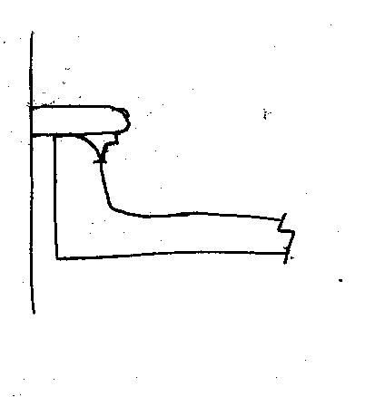

  13. TomC | May 22, 2006 05:30am | #24
    Start selling a tile job or you can do something like this, similar finish as the oak trim on the door.

  16. pickings | May 22, 2006 08:47pm | #32
    Cut the top 3/4" of the BS off leaving about 3" with a square top. Take a 1 X 2 piece of maple or oak (stain, and finish to match the cabs) laid on the flat. Run a 1/4 " round over bit on front/top and front/botton of it.  Butt the square back of the 1x2 to the wall, pull the counter out to you desired overhang, nail the 1x2 to the top of the BS, and you now have a 1 1/2" wide "mini plate rail" for photos, decorative tiles, etc.
    PS. Mitre the corners.....looks cool.
    Used this detail once to finish a 1 course tumbled marble tile BS that was 4" high and 5/8" thk.
