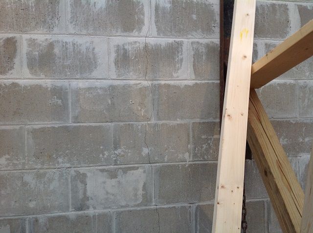

Hi everybody, my Wife and I are building a home, a two story with a walkout.We drove to the site tonight to see how the house is taking shape. The have poured footings, set block foundation, backfilled and started to frame the basement. While looking around we noticed a crack in the foundation from the very top couse of block all the way to the footing. It’s cracked through the center of blocks and also through mortored joints. How is something like this addressed? The builder hasn’t said anything about it, but I think it has just happened. I have pictures and have contacted our Rep to see what they say.

    It is a full block wall between the basement and garage. It is not buried. When you walk in from the garage, you would step over that wall in to the mud room. Hope that makes sense. It's a straight crack from the top to bottom.
    I do have pics, but I'm not sure how to post them up.
  4. MN Charlie | May 08, 2014 10:04am | #9
    Trying to post a pic. I resized it. We'll see if it is clear.
    1. VaTom | May 08, 2014 10:28am | #10

        1. sapwood | May 08, 2014 11:17am | #12
          The location of the wall isn't important unless one wishes to fully analyize the structural situation which is impossible for anyone who isn't there. That crack in the wall looks for all the world to be the result of differential settlement due, probably, to insufficient compaction prior to placing concrete for the footing. I would recommend you get a licensed structural engineer who is well versed in foundations (yes there are specialties) to look at this and give recommendations. The contractor will probably try to stonewall (no pun intended) you.

    2. DanH | May 09, 2014 12:04am | #17
      It is curious that there is what appears to be a temporary wall brace directly adjacent to the crack.
  5. MN Charlie | May 08, 2014 06:27pm | #16
    The Super and Engineer met out at the build site. He isn't requiring the wall to be removed and rebuilt but has required several things to be done. Underpinning the footing, all blocks filled and crack filled. I will find out more soon.
