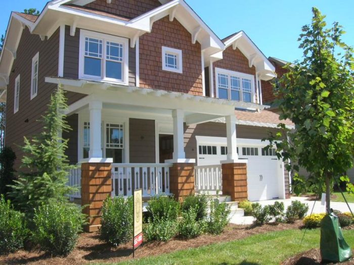

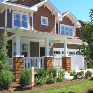

            Are you guys trying to remember the name "Permacast"?Here's some columns that I saw in a magazine that I liked:View Image
            Matt | Nov 15, 2007 02:50pm | #9
            Thanks John.  It's a nice looking house in the pic.  Some comments:
            1) if my wife lets me build another house, I'd like to use the cultured stone on the foundation and have stone steps like that.  I've been working on her for a few years.  :-)  My attitude - current house has worn and dirty paint.  Time for a new one :-)  She has agreed we need to downsize, we just haven't met on how far to downsize.  She says she wants the craftsman stuff so that would be the look.   Building lots are really hard to find though.
            2) I really like the way those column bases stand out from the porch.  That is one detail that I got in the drawings for the current (upcoming) project.  It is a subtle design element of the craftsman style that alludes many people.  It really helps the top of the (large base) columns hit the beam right too.
            3) Those columns have a lot of taper on them.  I kinda like the look, but it would require that the porch beam be lined up with the columns exactly right.  It's easier to go with less taper and get yourself a few inches of leeway.  A lot of this goes back to the drawings - which is where we are at right now.  I'm not sure if this archi understands this whole concept.  I put it in my notes to him and on my initial sketches.  For some reason, I find that this whole thing is something that alludes many architects and designers.
            4) I like the look of those foundation vents, however on a low foundation like that I'm not sure how practical they are.  A while back I looked around on the internet for some vintage looking vents and found some cast iron (or aluminum) ones that looked pretty cool.  I'm not sure if they "operate" though, and I'm virtually positive the ones in the pic don't - they sell those kind at my regular BS.  The thing is that to me, including the space under a porch in the crawl space is just wrong - unless the porch floor is waterproof - which is somewhat problematic.  Heck - the next house I build might even have an unvented crawl space - it will have a crawl space though.
            5) I also really like the look of those wing walls on the steps.  They don't meet code requirements as far as a handrail on the stairs though.
            5) those window upper sashes on the main house 1st floor have an unusual mutton (grill) layout.  Kinda cool.  Not sure what it would be like buying those in "affordable" windows though.  I like the ones on the garage and they are fairly readily available too.
            Like I said - it's a nice picture.

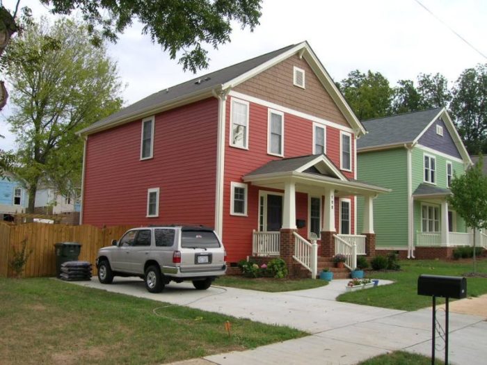

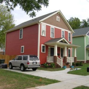

  2. user-51823 | Nov 15, 2007 06:56am | #7
    i like jag's 1 in 3 also, though i've never seen craftsman columns on what i think of as a ranch-style house.
    Don't forget the double column-
