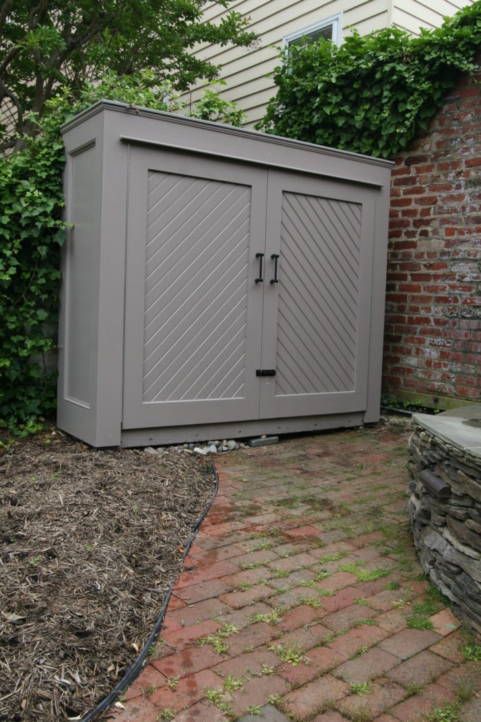

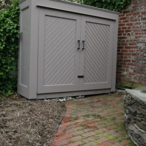

            We've applied that very same concept to a 7' tall garden shed. The only thing wood on this exterior elevation ARE the railes and stiles of the doors. Everything else, including the recessed end panels are PVC. This shed is made to be portable. You can disassemble it in about 10 min and move it as components. The "flat" roof is a stone tiled shower pan with aluminum parapet counter flashing.
