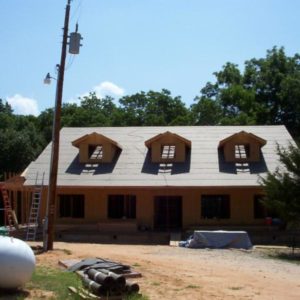

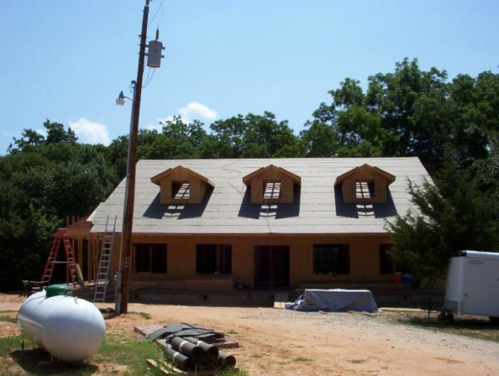

I have a 3′ tall crawlspace with 14″ joists. It is surrounded on all sides with a 10′ porch full of sand (concrete stemwall and porch floor). I put four 10′ long 8″ ducts for vents on all four sides of the house (16 total) that can be open or closed.
Do I still need to do some kind of insulation on the inside of the crawlspace?

      That's got me head scratching just now.  It sounds like the porches have sand fill from their stemwalls, back up against the perimeter foundation wall.  So, they may actually be insulated, with 10' of sand.
      Profile says Stillwater OK.
      Building Science says that's Mixed-Humid, and recommends a conditioned c/s.
      With those prominate dormers, and the advanced state of construction, I'm thinking that the recommendation would be to seal up the c/s, & foam the roof deck.  Run the hvac returns in the c/s and the supplies in the attic.  That would keep all the ductwork & equipment in some sort of controlled space.
      My only concern would be how the perimeter foundation/porch deck/floor deck joint is handled.  If I've "got it" right, that is.Occupational hazard of my occupation not being around (sorry Bubba)
      1. whardy7 | Aug 04, 2005 10:23pm | #5
        A couple of questions, then.
        1)Conditioned crawspace that is sealed - should I plug up the 8" tube vents going through the porch floor? Is that literally what we are talking about being sealed and conditioned?
        2)What do you mean about the "deck joint"? If I can understand what you mean by that, I can explain how I did it.
        It seems to me that the crawspace is as sealed as any could be (excepting the vents I put in) because of the 10' of sand and concrete. But, I am not sure if I should put something on the inside of the stem walls - a coating or some insulating board. Seems that would be redundant.
          CapnMac | Aug 05, 2005 01:49am | #6
          Yes.  Could remove the vents, too.  Some of the reasons for venting a c/s involve ground gasses, but mostly, venting for the c/s is to give an easier path for moist warm air to flow out of the c/s instead of up through the floor structure.  Building Science (rightly, IMO) is 'against' any scheme that allows moisture-laden air to build up anywhere it might later condense.
          The joint where the house foundation translates into the floor & wall structure and where the wrap-around deck terminates against that structure.  There's a number of way to detail that, from a wider ledge on the foundation beam, to mirror the porch's stemwalls, to a rim joist for the deck against the house's rim joist.  When you said sand, my brian starting trying to kick back which way a termite shield would go in, which then got me to wondering about the deck v. house flashing.
          More sealed, in some ways.  I want to say that a foot of earth is like R20, so, you have a lot of thermal mass agains the c/s walls.  I probably would have waterproofed the house's foundation wall before backfilling with sand, but I'm belt and suspenders that way.  You may need some insulation where the sand fill "is not," usually with a bit of overlap to prevent bridging.Occupational hazard of my occupation not being around (sorry Bubba)
