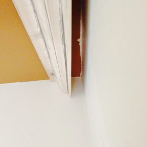

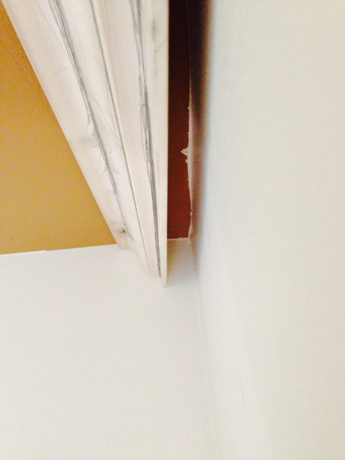

Hi, I am installing crown molding in the dining room and one wall that runs just over 9 feet isn’t as straight as it would appear.  About 2 feet from one corner, it bends in quite a bit.  Enough so that the bottom of the molding at the corner, is 1 3/4″ away from the wall.   Any suggestions on how to deal with this?  It’s too big to caulk and I like my trim work to be as professional looking as possible. Also, we just painted and so, redoing the drywall isn’t a first, second or third choice, according to my wife.
Thanks. (I am trying to post a pictures below, but this forum site is very wonky with my first generation iPad.)

    Thanks for the suggestions.  The house is old [100 years] but the wall is not.  And along the baseboard, straight as an arrow so it's just up at the top, that it dives in so radically. I've checked with a few different pieces of crown molding, every time the gap is there.  Its too bad too because its on the front wall and everyone looks out the window and a joint above it would really stick out.
    I think they happened to make the stud using a scrap piece of timber that was hack, or they attached the top of the drywall to a 2x2 furring screwed to the brick exterior wall.  Regardless, I have to live and work with it.
    I like the idea of a backerboard and wondering if using some dentil molding or some other profile would help distract the eye enough to get away with it.
    I think I can attack the photo, givn' it a'nother try.
