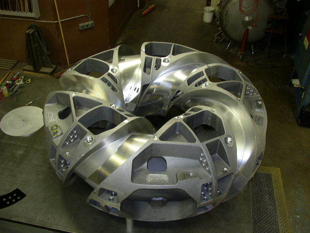

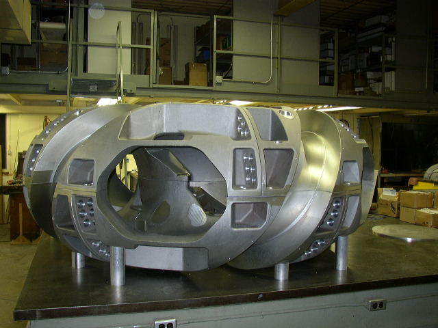

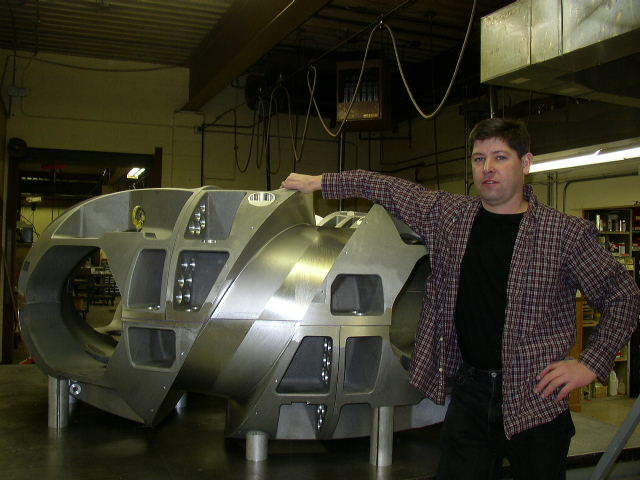

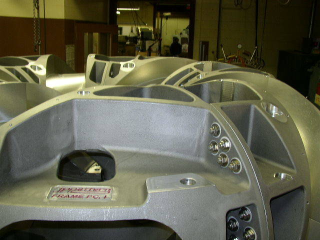

While having nothing to do with “Fine Homebuilding,” I thought some might find these pictures of interest. We’ve been working on this for a long time and now it is nearly ready to ship. It is the support frame for an experimental fusion reactor that is being built at Auburn University.

Seriously, that is some fancy casting and machine work. And it really does look prety darn cool....that's not a mistake, it's rustic

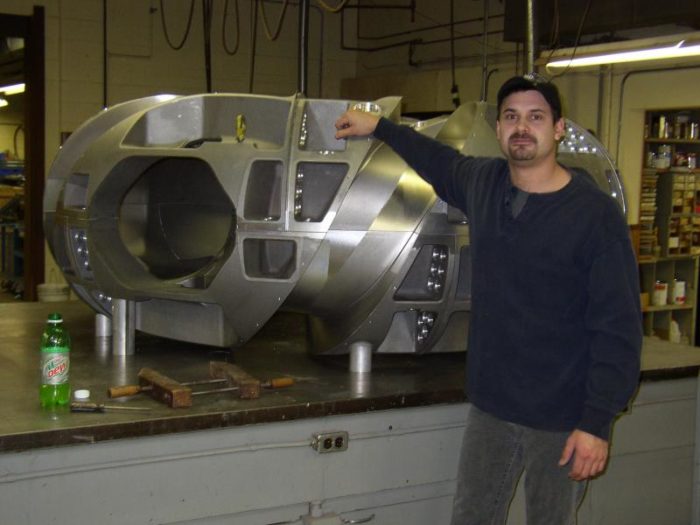

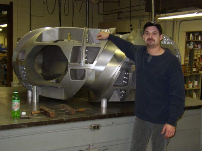

And it was all done on a 3-axis CNC! I wish I could take credit for the machine work, but my role on the project was limited to pattern work and some "punch list" type stuff. The guy who did the machining is one of the best tool makers/machinists I know of, Mark S. (see attached pic)
The Mountain Dew makes sense, but the wood clamp is an odd anachronysm. It must have been from the early days, when nuclear reactor parts were glued up from several carved tree stumps....that's not a mistake, it's rustic

Actually, just an example of our guys being able to efficiently think "on the fly."
The tolerances for the unit were quite close. As the unit was being assembled for the first time, the plates that electrically isolate each section were a bit of a tight fit (easily explained by temperature fluctuations at the facility). We could have designed a "reactor stretcher," but Mark looked around, spied an old style wood clamp, and used it in reverse against the webbing to create the extra couple of thousandths clearance needed to get the insulating plates in to fit.

I love it. High-end machined reactor component corrected by old wood clamp lying around.

at thte risk of asking a question that may have already been asked...... how did you build the pattern ? what was the medium ?Mike Smith Rhode Island : Design / Build / Repair / Restore
C'mon...we all know ....PLAY-DOH..
"how did you build the pattern ? what was the medium ?"
Mike,
All CNC machined out of Honduras Mahogany.

What alloy is it made of?
"What alloy is it made of?"
Tom,
Not positive, but reasonably confident 356-T6.
