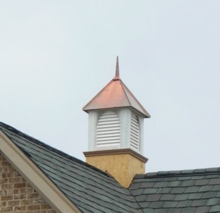

Its all a loose fit and not screwed together or plumbed up. It has to go up in 3 pieces, and I had to leave some slop for the installers. So I guess Grant has the copper on by now, and its on its way up somewhere..LOL
A good painter can make it sweet. NMJ to paint.
All the insataller needs to do is cut the roof angle and cleat/flash it, then the louvered waist slips over the base, and is screwed through the trex water table. Then the copper clad roof can be set atop and squared, leveled and screwed through a cove type crown that is permanantly glued and screwed under the Advantec substrate..I hadds figure a way to make it idiot proof and not screw through the copper clad..other wise it would have to be clad on the roof after assembly..that sucker is 3 pcs for ease of me getting from my shop to Grant's and its also pretty heavy.Spheramid Enterprises Architectural Woodworks

Looking forward to a slight design tweak. I see now I should make the roof..higher up..its just a little too close to the arch top to my eye.Spheramid Enterprises Architectural Woodworks
yah. take a couple inches off the base and add to the face for better proportion
Actually, the roof could have been installed a little higher..I made the 3 sections so one slips on the previous, and then screwed together through the trim. Other wise it would have been next to impossible to install.
Once I decided to use the gable vents, it skewed my dimensions a little and was trying to keep close to a sketchup pic I had from Grant for the general look.
Considering my back was so bad during that fab. I had to work an hour then layout for an hour, it was a miracle I even got it made.
In the future I can tweak it a little more and make the installers part even more fool proof...Spheramid Enterprises Architectural Woodworks

They are vinyl. Rectangular gable vents screwed on from the inside..
Clever huh?Spheramid Enterprises Architectural Woodworks

26 bucks each. 20x26 IIRC. That cupola is 6' tall.Spheramid Enterprises Architectural Woodworks

The finial is made from sheet copper and is riveted on.http://www.quittintime.com/ View Image
Excuse me but if you put a big copper pecker, sticking up on the highest point of a house it IS a lightning rod.
If you don't provide a ground path, the lightning will do it for you.
Just a thought, but that base and trim above would have been a good spot for Azek. At the very least I would have painted it before it went UP there.
This is a "count every penny" new home builder. They have a painter that's bid on the job. They wanted my "best" price. You don't get paint with the "best" price. They're lucky Duane had the other trim already painted.http://www.quittintime.com/ View Image
He and or the painter were not thinking that process through. Cupola's are a real nice touch on the right home or barn.
I made it, and the base is Advantech, the trim is Trex, any wood like the corners (WRC) is primed.
Paint was , as Grant said, not our job.Spheramid Enterprises Architectural Woodworks
I like that trex trim thing. Just starting to hear more about it used in a trim application. FYI, my lumber yard has just started carrying Trex shims. I can think of alot of applications for them.
I had intended to have it be almost all trex. I ran into issues with it not being true enough for my likes. A 5/4 x6 was fatter in the center than the edges, and it would have required more finish milling than I felt was worth it. So I'm not sold on it as a wood replacement for much more than decks and ripped, then machined into watertables and sills.
The weight was another issue, Trex weighs a ton compared to WRC.
I try to make a product that won't disintegrate if weathering happens from lack of painting, but ya gotta draw the line somewhere if ya have a budget constraint. I'd say it was a good composition of materials for longevity.
With pocket screws and great glues, judicious use of new longlife materials, things like that should last quite some time.
I've repaired and repainted wood louvers, and I'd not wish that on anyone, if it's avoidable. I spent a solid month re-habbing a bell tower from an old school house..ya don't forget the hell of that quickly.Spheramid Enterprises Architectural Woodworks
