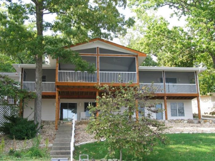

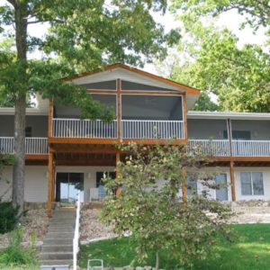

Trying to decide what size, 2 or 1 and if 1 on the lower or upper ridge.
House is 73 feet across the front (23′ is garage).
Been thinking one on the lower ridge around 30″ high.
Any and all advice appreciated.

    as decortions only I would limit to one on the top ridge.
    As functional venting, i would do two, the top one slightly larger than the garage one
    1. Ozark | Aug 02, 2008 08:41pm | #3
      Non-functioning is the plan. DW wants two and me one. I guess the vote is tied thus far. Getting a new roof (hail) so I want it to look right.

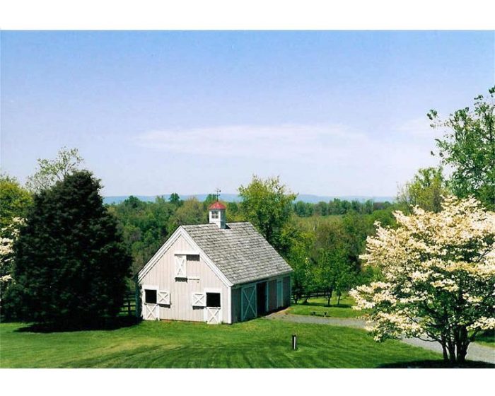

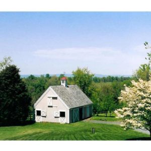

          I built this cupola for my barn. Paid atention to proportioning it right as I wanted to give the barn a little "signature". Where I lived everyone put a lot of thought into the house but when it came to the outbuildings, they all had T-111 with 1:12 roof pitches.
          This barn was copied in various forms by several neighbors. I built the cupola on the ground and when I got it done it was heavy. The barn builders said they could haul it up but I opted for a crane which weighed it in at 600 pounds.
          Sorry the photo's not that great but everyone commented on how nice the cupola looked. Kept the hay loft well ventilated while at the same time providing lots of light.

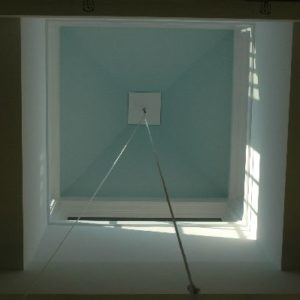

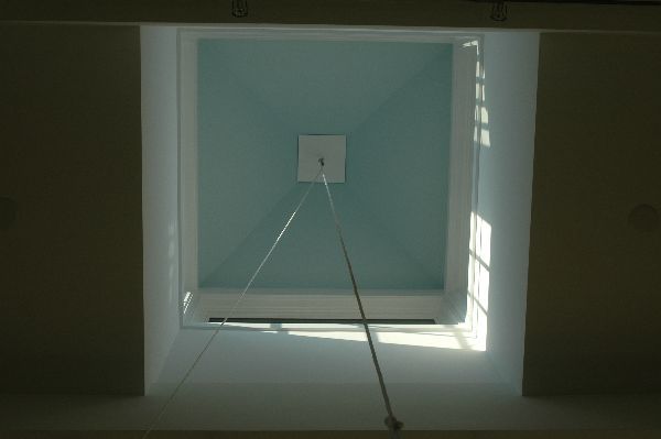

            Here's one on my house-larger that the 1" to 1' rule of thumb, more like twice that. It does a good job letting out the heat on those rare hot days in Maine. It has two openable electric windows and two fixed windows.  Inside, we put a pulley at the top and hang stuff (Christmas decorations, kites, etc.) from  a rope running from the pulley to a cleat.

            "Inside, we put a pulley at the top and hang stuff (Christmas decorations, kites, etc.) from  a rope running from the pulley to a cleat."
            I once lived in a real barn. (Now, when somebody yells "Close the door! Were you raised in a barn"? I can reply in the affirmative. Well, not "raised", exactly. But still, . . . . Had a real cupola too!)
            We also found the high rafters excellent resources for Christmas decorations, etc. Once, after a few too many beers and hot toddys, we went out to a tree farm to cut down a tree. We found one in the middle of the field that looked good. We proceeded to cut it down, not noticing how long it was taking to get the saw through it. When it finall fell, two of us couldn't lift it onto the car (and not because of the beers.) It was a tad bigger than it looked out in that field. Way too big to fit in any tree stand, or to get it upstairs to the living quarters in the barn. We had to hoist it with the hay crane, hang it from the rafters, it's trunk suspended in a tub of water. Best tree I ever had.
            Mike HennessyPittsburgh, PA
            PS: I was gonna say yours is more of a clerestory than a cupola, but that's probably not technically correct either. I'm feeling dumber and dumber as this thread continues. But I still don't like cupolas on ranches. ;-)
            Edited 8/5/2008 3:10 pm ET by MikeHennessy
          8. smslaw | Aug 05, 2008 10:26pm | #33
            It is about 26-27 feet from the floor to the peak of the cupola.  I wanted to get a huge Christmas tree to put under it, but DW reminded me that a 25 foot long tree would be a bit heavy to drag home from the woods.  Even the ten footer we got was pretty awkward to set up.
            Our pulley system was not designed by an engineer, so I'm not sure how much weight it will bear. After a few beverages, anyone visiting usually has some creative ideas about what to suspend from it.

    I'm with alot of others on the look of a cupola on a long and low ranch, however, if your heart's set on it I think my placement would be over the front entry door as well. Sometimes a little oversize might not be too bad, maybe with a hip pitched to match your house (with metal roofing). Maybe even a lighted cupola to give it a little bit of function (you'd be able to see your house from the water). That said, after the cuploa is up the entry would be begging for an update, maybe and entry portico with some nice columns. See how easy it is to spend others money??
    1. Ozark | Aug 05, 2008 07:38pm | #28
      Giving up on the idea of a cupola. Just trying to dress up the front. I am going to put a portico over the front door. Will use 6X6 cedar to match the lake side. Have thought about faux shutters. Fat fingers, pics are the same.
