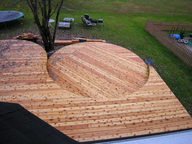

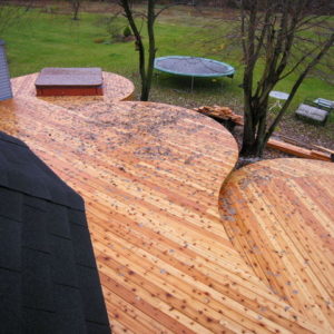

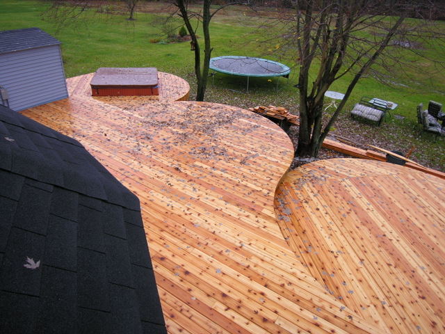

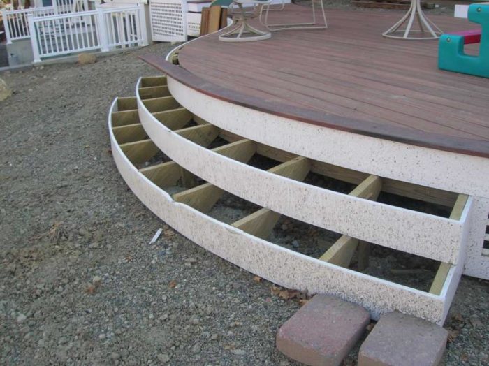

I could use a little help. I built this curved deck last fall, but got shut down by the cold before we could heat and bend the border. The home owner hired someone to review the work, and he had a few comments. He didn’t like my choice of two layers of 3/4 pt plywood for the outside rim.The curve was tight enough that we had to kerf the back in places. He says the plywood is and will de-laminate. I didn’t think this would be an issue with pt. He says that when he bends rim joists ‘we glue laminate pcs. together in the mold of the curve. We build up the laminate to 3″‘. He doesn’t say what material he uses to glue up. The deck joists are supported by a beam under. I also didn’t put on hangers. (some places you couldn’t) How would you guys do it? Here are some pics.

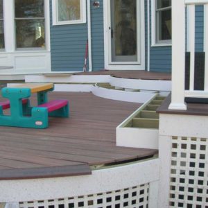

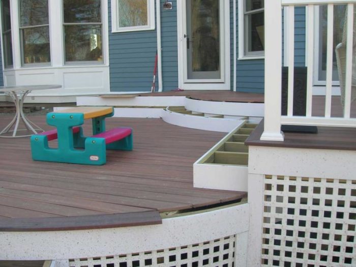

    I used for my curved rim joist 3 layers of 1/2" glued and screwed to the joist ends. No kerf needed but it did take some pushing and shoving. So he might have a point on that. I used lots of hangers and brackets where I could, more to make the inspector happy than add strength. This one is my deck so I'm still working on the railing.
    Looks like your using trex type material and for this you need a hot box. Build out of plywood and electric baseboard heaters so you don't have to wait for the hot days of summer. The radius looks a little tight for 5.5" wide border bending as it might crack.

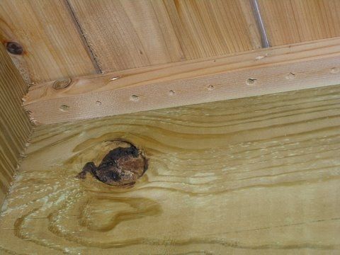

    Third picture is the hidden fastening method I used.

    depending how far those joists cantilever over the beams, the curved lam rim joist is not structural. It is only there to maintain alignment of th ejoist ends and to provide a nailing surface for the trim. If the trim gets nailed at joists, it doesn't matter a bit if the ply does de-lam a little, but I doubt that it would do much. If you do see some happening now, just inject a little gorilla glue to stabilize it and make them feel better. A little suger pill.

    I do not have a problem with your plywood bending although I may have gone with 1/2".  Last summer I retrimmed a front entry way with Azek.  I bought 5/8" 4x8 sheet thinking that it would bend like 5/8" Azek beaded trim.  I was wrong.
    I had to kerf cut the azek about every 3".  HO didn't mind, but you could see where the kerfs were cut.
    For a curved deck, I would layout the arc and cut the joists.  Blocks could be placed in between the joists (i.e. like solid bridging), and the trim/riser in pic would bend around the end of the joists.

      I have done it he way you are suggesting with blocking between the joists the curved facade material is just for looks. I add shims between the joists nailed to he blocking so there is support every 8 inches. Then used fiber board siding to bend the arc.In stead of an trim board following the edge, I over extend the decking and cut that to follow the radius of the structure.Wallyo
