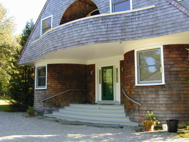

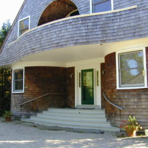

          red cedar shingles love curves...here's a 25' radius ...

          5. MikeSmith | Feb 08, 2003 05:35pm | #11
            dumb, no.... there are lot's of houses with round wall sections that have horizontal siding.. all of the clapboards are ripped to the correct curve..
            if i had a customer who wanted that effect in FC, that's exactly what i'd do.. and it wouldn't be a big deal.. i'd set up a jig, hook up my makita fiber cement saw to my fein auto-vac.. and have at it..
            i'd get well paid for it too..
            naturally i'd point out tho the customer that a more traditional system would be red cedar shingles..
             the example i showed was a 50' diameter in  red cedar..
            i've done some 14' diameter in red cedar also.. they were more formal that the example

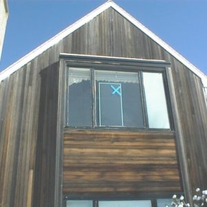

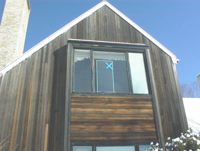

            I went out today to measure a window replacement job. It turned out to have interesting siding that I've never seen before. It made me think oif this situation.
            It is clear vertical fir 1x4 T&G on a house built in about '72 and has held up well..
          8. FastEddie1 | Feb 09, 2003 01:57am | #17
            That looks cold!  We had a light dusting of snow here last night...lasted about an hour or so, although a little more up in the hill country they had an inch or so.
            Vertical siding might be an option.
          9. Piffin | Feb 09, 2003 03:01am | #18
            It had warmed up to about 20°F when I shot the picture. Supposed to be below zero again tonight.
            When I went inside to check things from in there, it was colder in the house than out(vacant for the winter) and I had taken my boots off to protect the floor so my feet were glaad to be leaving by time I was done..

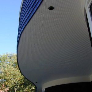

            like piffen said.. trial & error.. you can figure it mathematically.. but really, you  either tack the piece up and scribe a level line on it with a laser, or you cut a pattern out of luan ...once you have the curve you can transfer it..

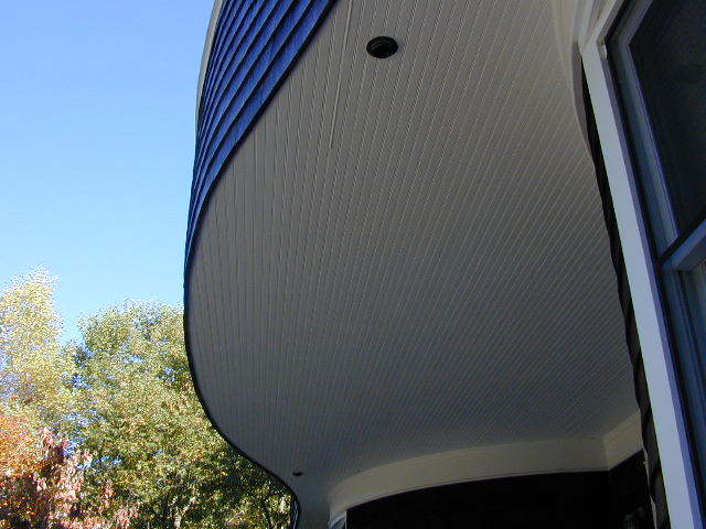

             here's a twin round front victorian we built in '85.. the flanking round rooms are 14' in diameter.. there are also some curves in the 2d floor balconey... and the soffits are all beadboard
          11. Piffin | Feb 09, 2003 07:01am | #20

          12. MikeSmith | Feb 09, 2003 07:05am | #21
            yes , it would... ... but, that would give you the bottom cut.. i'd bet you have to make the top to the same curve to get it to lie right.. which will just slightly alter  the pattern.. so maybe one more set up to get the right pattern..
            as to the face .. hell, you know me.. i just keep recycling the same olde pics..
            they're always new to someone, hah, hah, hah

          14. MikeSmith | Feb 09, 2003 07:24am | #23
            well , suppose we wanted a 5" exposure.. so, we'd need a 6" to 6.5" finished clap.. well we'd have to cut it out of an 8" at least..
            when you bend it the top won't lay in.. so you tack it up.. shoot the top cut and the bottom cut with the laser.. take it down .. cut it.. then tack it up .. now it 'll lay down close enough so you can get the final marks with the laser..
             take it down, and cut your pattern.. should be good to go.. unless of course it takes three shots

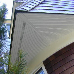

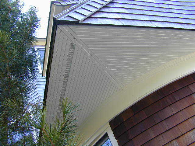

          16. Lateapex911 | Feb 12, 2003 09:02am | #26
            Nice stuff, Mike!  What is the shingle detail called at the roof edge?Jake Gulick

          17. MikeSmith | Feb 12, 2003 03:28pm | #27
            jake... i don't know what it's called... that one was a red cedar roof edge board, and the gable end was red cedar rake shingles 5" wide at 5" exposureMike Smith Rhode Island : Design / Build / Repair / Restore

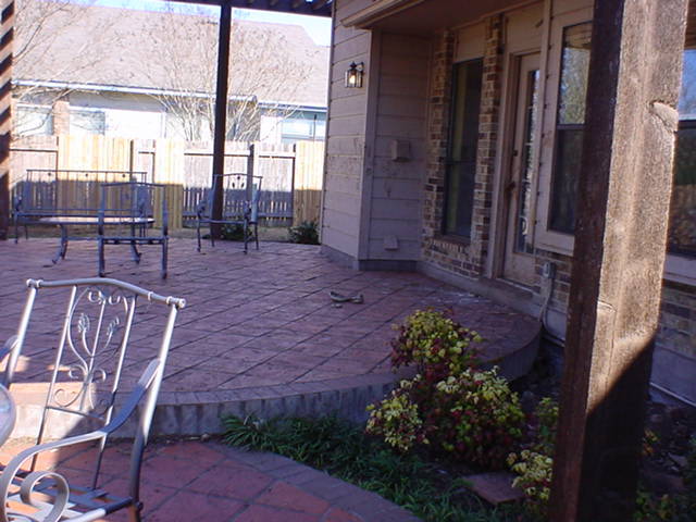

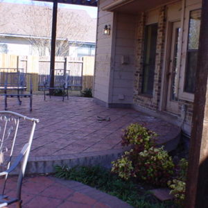

          18. FastEddie1 | Feb 12, 2003 05:17am | #25

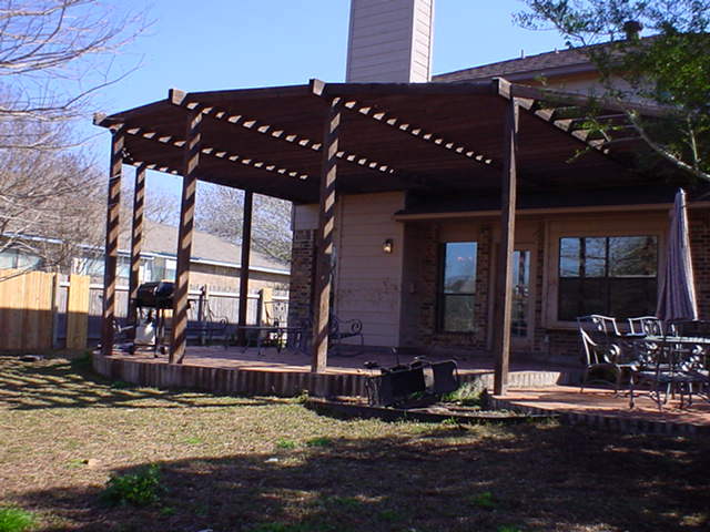

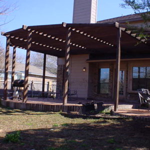

            Here's a picture of the back of the house.  hard to tell, but there are two round slabs in place...one is 25 ft dia, the other is 9 ft dia.  The existing trellis is flat and of course very porous.   Idea is to remove the exising trellis and build a screened & shingled room.  Reason is that they have a new baby and two dogs...the dogs make the patio unusable, and they want a little non-dog space for the baby to play.  one dog is an adult golden retriever, other is a Weimaraner (sp) puppy...they're chewing everything in sight...look at the paw prints half way up the wall by the light fixture.
