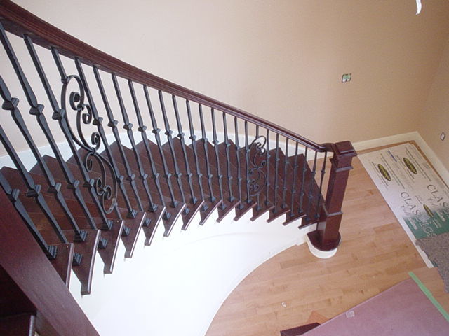

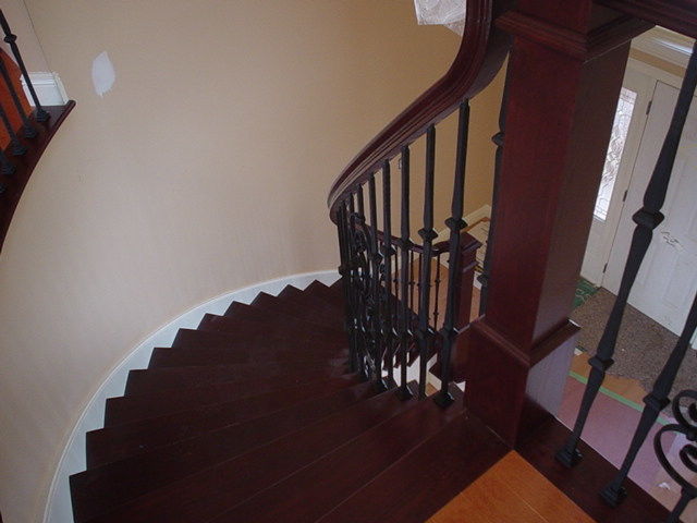

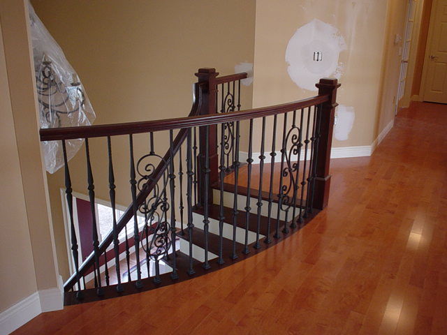

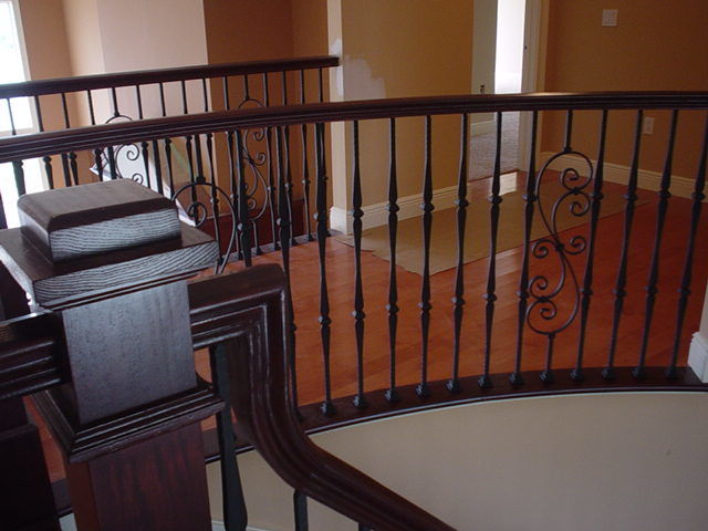

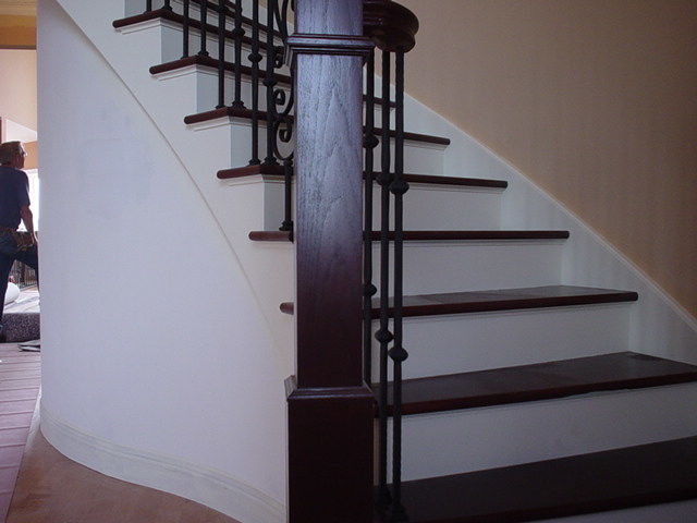

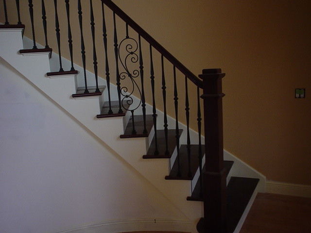

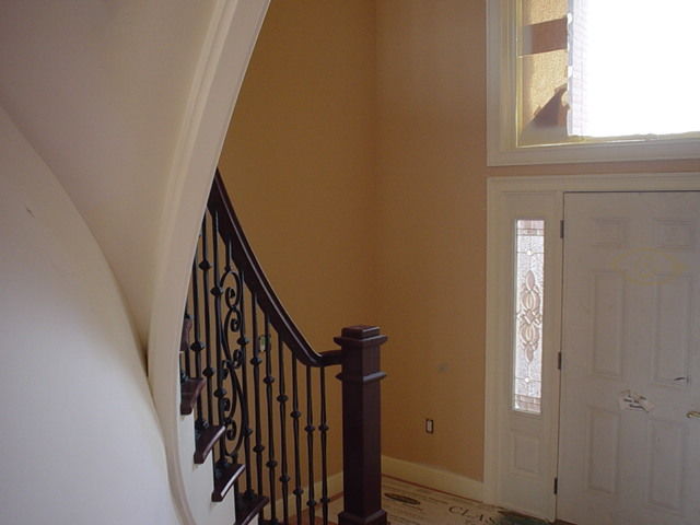

Just fininshed a little curved stairway with iron balusters. Here are a few pictures.

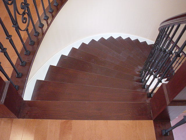

Did you make those posts, or are they ordered? Also, what kind of floor is upstairs, and did you cut the floor to your radius, or have your board in first?

Hook: Thanks....I milled the curved landing tread then installed it. The flooring guy fit to it and did a real nice job.
Those newels were ordered out. I usually make my own..but there were 13 of these in the house and the time involved had me just order them out.

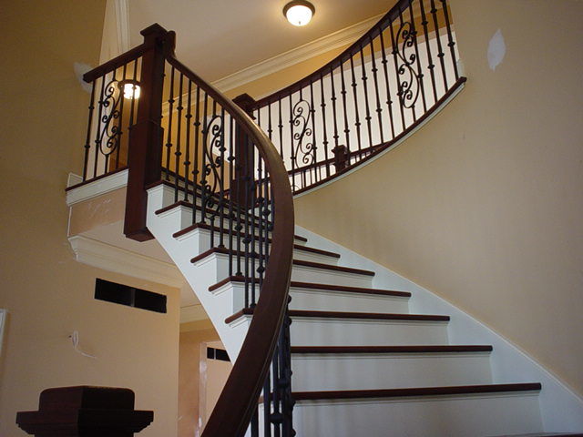

How do you capture the radius of the existing wall, so that you can go back to the shop, and build that curved wall which you construct your stair off of ?
Do you just capture the radius somehow, or do you cut out full sized templates ?
Joe: I insist on laying out the curved walls for the framers. In case it is already done ahead of time and then they contac me for a stairway...I have yet to have one that was framed right. I then have to adjust my riser lines to allow for the error in framing layout. What ALWAYS happens if I dont lay it out beforehand is...the top header is on the springline of the stairway. This is the line that points to the geometric center of the stairs. The riser faces should all point to this point. The framers never set the top header back the thickness of the riser...plus 1/2 inch wiggle room. It never has been layed out right for me yet....so...thats why if I have a choice...I will draw the lines on the floor...and thoroughly go over with the lead carpenter. I then go and reproduce the foyer in my stairshop and the next time I am back is when we are lifting the stairway through the front door.

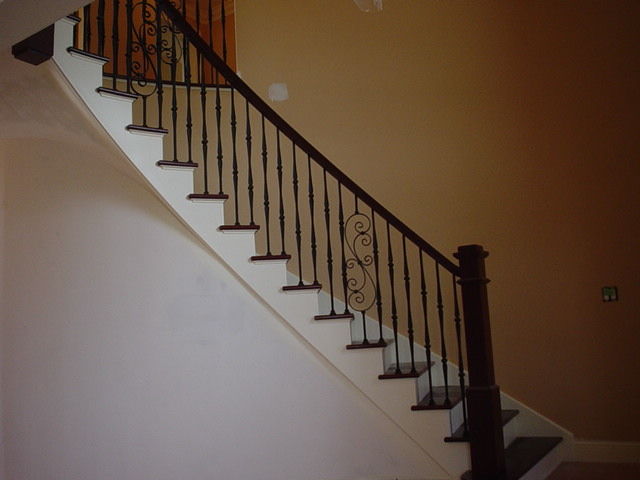

Looks good Stan, I like how you extended the top of your gooseneck out so you can have a longer drop. I do that when the balisters allow. I've been going higher on my level rail also. We use 39" balisters sometimes. I hate cutting a gooseneck down to a little stub. One guy I know calls them "goose easings". Did you make your box newels?
Allen: I make them sometimes....but since this storm..I just didnt have time.

Stan, I'll have to ask your indulgence in allowing me to edit a couple of your pics. Have I managed to get the correct "during" and "after" shots lined up?
Really nice work.
John: You have the right sequence....never thought of posting that way.....
