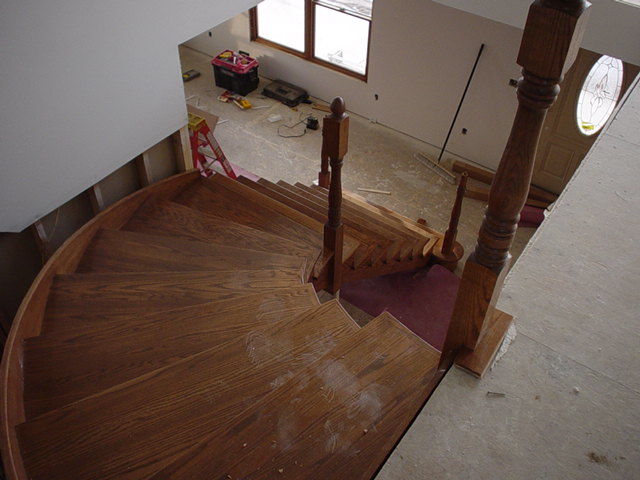

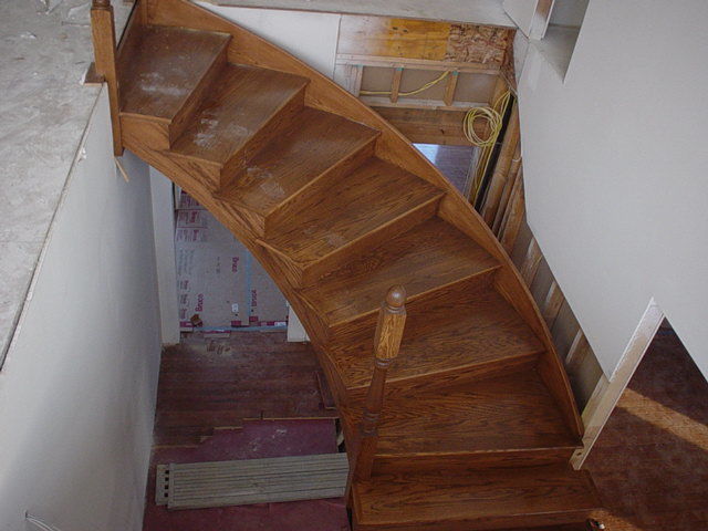

I just set this stairway a few days ago. It is just a simple one with a top curved section.

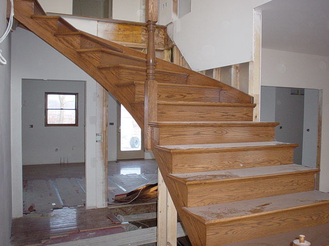

This stairs is out in the country and the owner wanted a post to post handrail newel at the top of the straight section. This would not pass code in the bigger towns I work in.
The owner is going to put an arched doorway underneath the stairway.

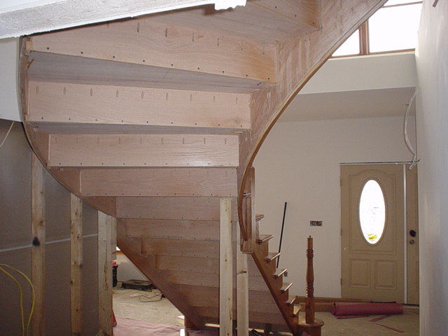

This is the underside of the stairway.

question: it wouldn't pass code ? is that because of teh "post to post rail".. ie.. becuse the rail isn't continuous ?.. or is there some other problem ?Mike Smith Rhode Island : Design / Build / Repair / Restore
Mike: The rail is interupted and your hand has to lift off and go over the newel. Doesnt or wouldnt ever bother me...and the client wanted the look.
However...had it been in the city of Champaign..etc. I would have never considered letting the owner have that.

holy pocket holes, batman!
rather than shoot the screws through the lower part of the risers into the back end of the tread - switch those to pocket holes and I bet the Kreg company would use you in their ads ;-)Steelkilt Lives!
Jim: Seriously....I was at the Indianapolis wood working show about 5 years ago talking to the guy at the Kreg booth. I was telling him how their tool completely changed my ways of building stairs. He said that one of his guys was moving on and offered me a job of traveling the country doing the woodworking shows. I just am not wired for a boom mike. :0)
This is the underside of the stairway, Looks totally screwed up to me, nice work as always. Is it just me or does it look like you prefinish these stairs? I would hate to think some of my methods are finally rubbing off on you. You getting any air time on your gyrocopter?
Armin: The owner wanted to pre-finish these stairs before I installed them.....I will admit its not a bad idea....but I am not interested in finishing.

Very nice work. Did you provide the stairs stained and varnished or did that take place after you installed them? I like the idea of providing them finished as some painters could screw up a wet dream and then try to blame it on you. No matter who created the problem yu can waste a lot of time that way. Better to have control of the whole process.
Mark
Very nice job, thought about getting a kreg jig for doing stairs, i like what you did with the risers. What model do you have, does it save time or add a little bit. I use 1/4" ply for the curved stringers and solid 3/4" wood for the risers, what are yours.
Johnny......I bought one of the first Kreg pocket tools.. I dont know what I would do without it. Best $140 bucks I have ever spent.

The walls. I expect that someone will frame them out to the stairs?

George: Thanks. Usually the curved wall is in place...but the contractor wanted to build it afterwards as he wasnt quite sure how he wanted to do the second level.
